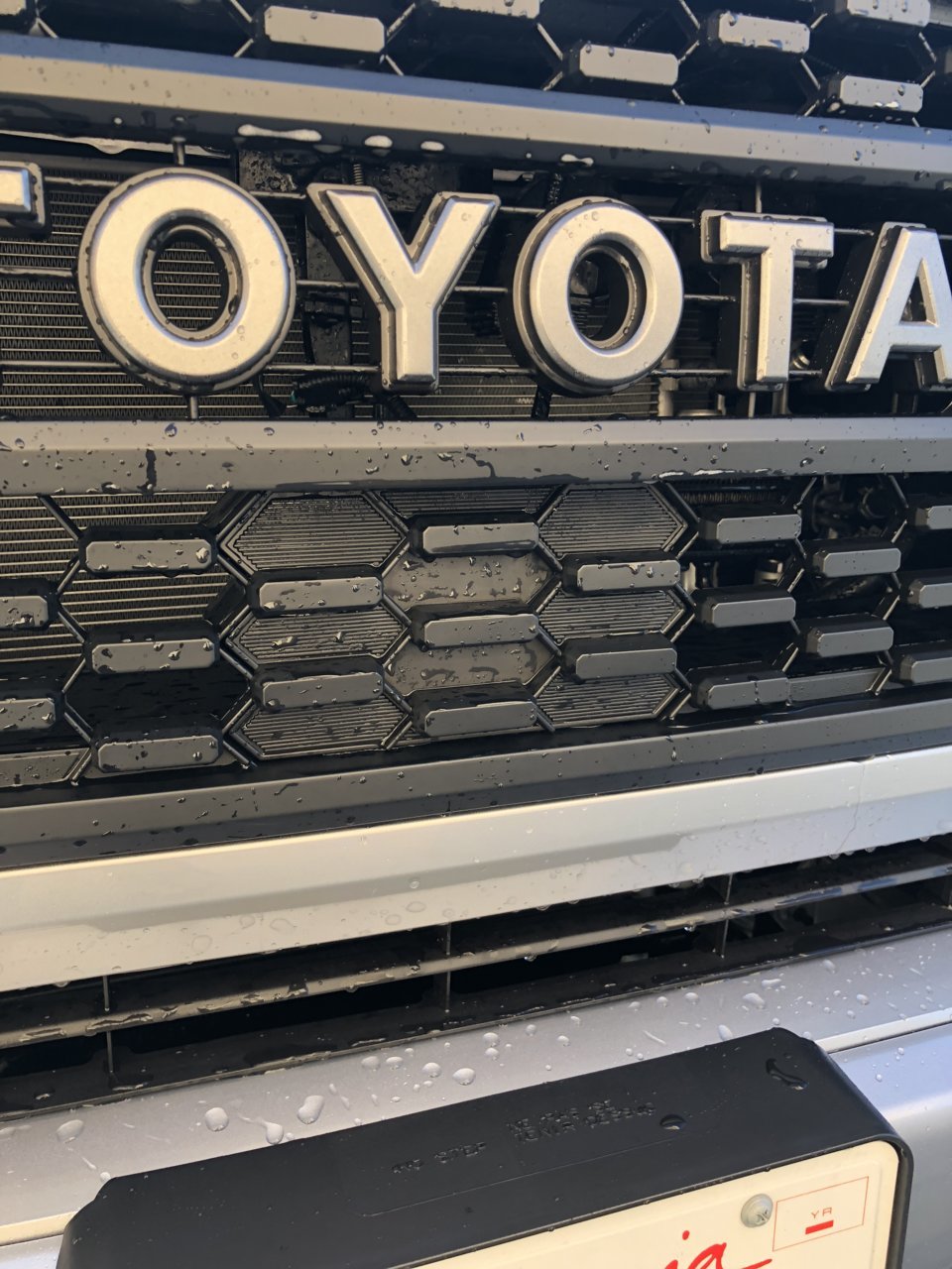

    I mounted my plastic piece on the honey comb and have about a 2inch gap between the sensor and plastic. I also only used enough plastic to cover the two holes only. No issues here and I’ve driven with it in in all types of situations.

    I glued the plastic piece of mine directly on the honeycomb piece as well and only used enough plastic to cover the 2 holes. No errors so far.

    This is what I did, and had all kinds of problems. My thought was also that it had to do with the honeycomb pattern. But OEM garnish appears to have fixed it for me. Don't know why.
