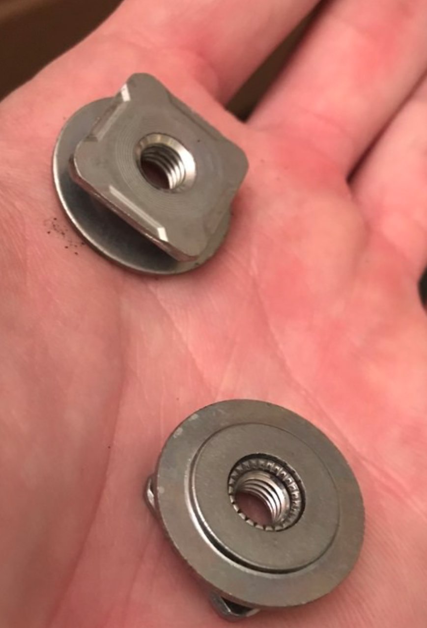

    Gotcha...does the grille come with these parts or do we re-use from the OEM?

    You'll need to re-use those.

    Cool...wanted to make sure the factory grille came with them.

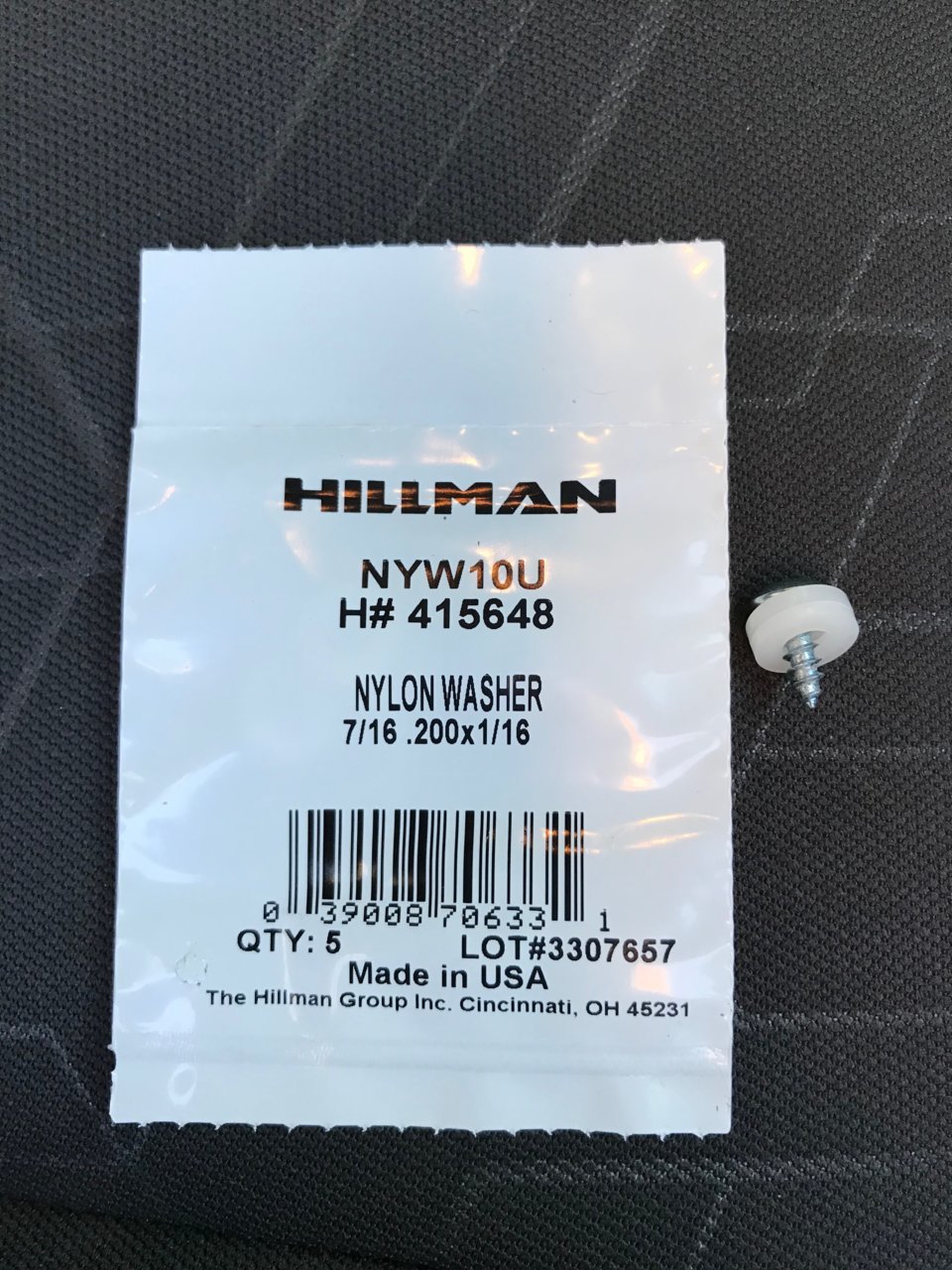

    For those that bought the Faux Pro grill from eBay that has the screw on logo piece, you may notice that the supplied screws bottoms out before the logo piece is snug (see video). I fixed it by adding some thick nylon washers from the local hardware store.

    That’s exactly what I did. Zero issues.
