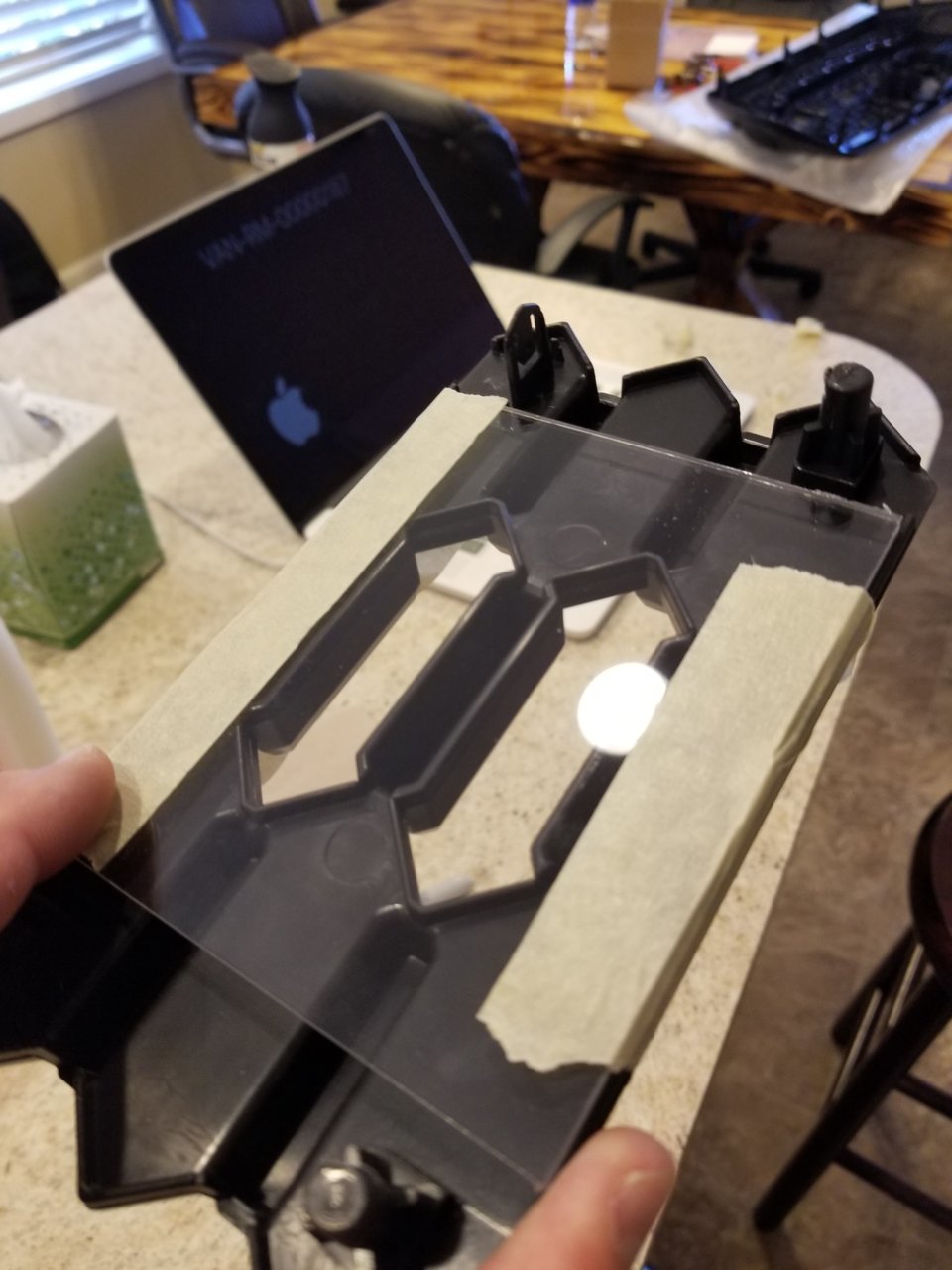

    He is correct for the TSS sensor but you will need two "push nuts" to hold the garnish. You can find these at ACE. Do not ask for "Starlock Fasteners" as they will not have a clue as to what you are talking about. Starlock is apparently a brand of push fasteners. Dug around in the hardware aisle on my own and found them....bought four different sizes (Total was a 1.78) because I did have the garnish with me and luckily got one that fit. I believe 1/4 is the size as mentioned up thread today.

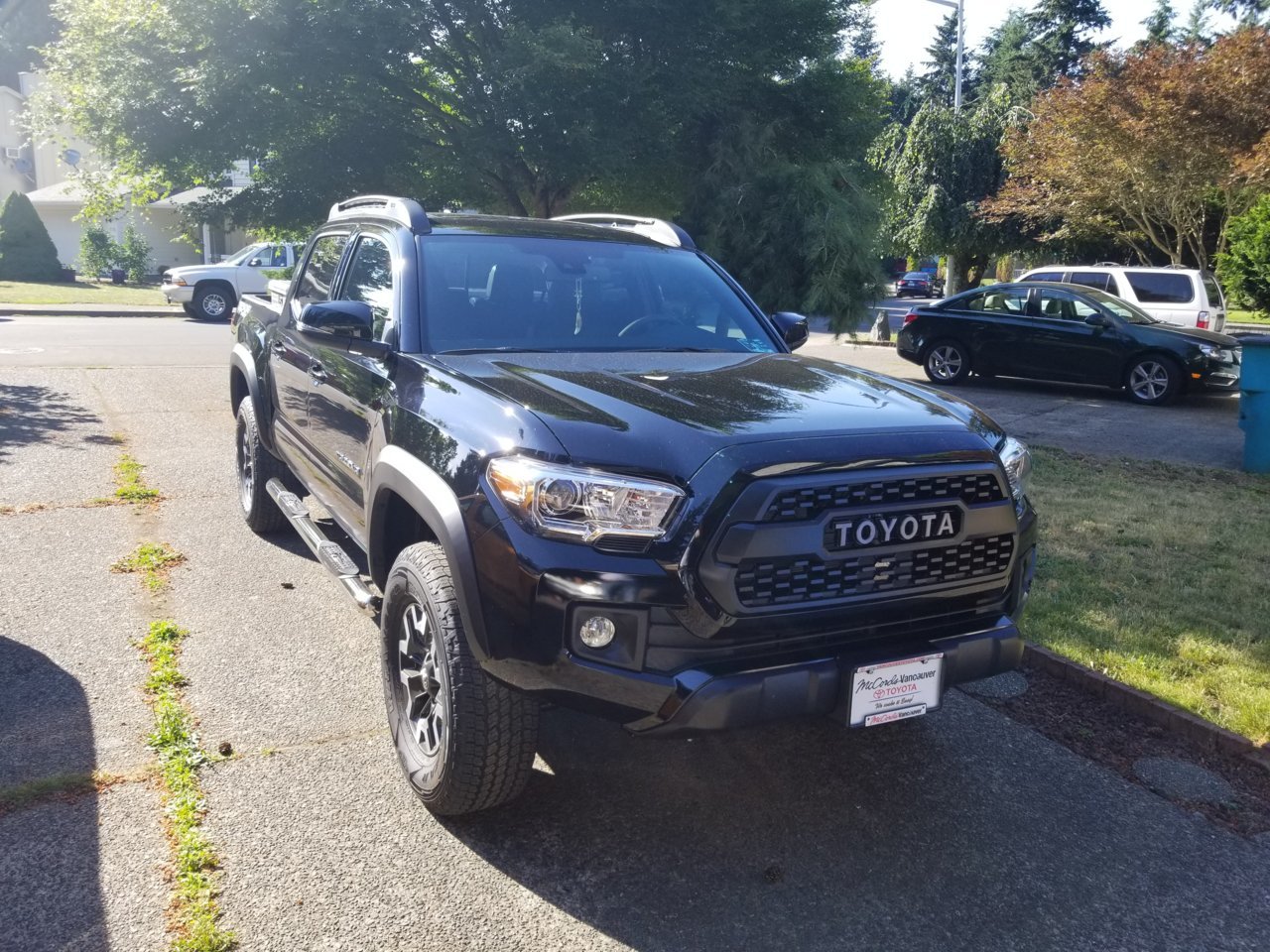

    Just finished installing my $80 TRD Pro eBay grille onto my '18 TRD OR following the instructions in this excellent post. It's a '16-'17 grille. I didn't buy the garnish, instead opting to cut a piece of plexiglass to size and silicone it onto the existing plate.
    Test drove it around the neighborhood, and verified that lane departure warning and adaptive cruise control both function without a problem.
    Thanks to everyone here for all of the information. I love this community.

    cruiserhead
    cruiserhead Well-Known Member
    Mar 6, 2017
    #212467
    536
    Curtice
    2018 TRDOR Cement DCSB. 1980 FJ40. 1978 FJ40
    Report back after some time on the freeway, etc. You are doing exactly what I first did, including th clear Plexiglass, and mine worked fine for a test drive, but then had problems later on.
    Also, just FYI lane departure is managed out of a sensor on the windshield behind the rear view mirror, so it shouldn’t be affected by this.
    Good luck, fingers crossed you are one of those that works without the oem garnish needed.
    nochalfjap[QUOTED] likes this.

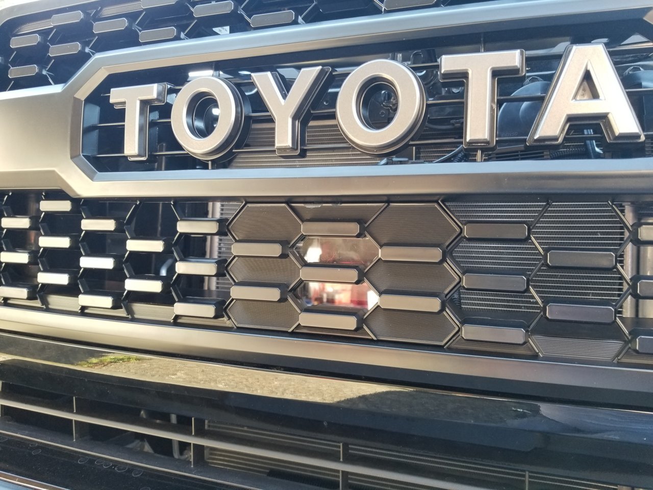

    my ghetto set up, Tupperware, has worked flawlessly for 6k miles now, rain, snow, dirt, mud, dust, fog, etc. i'm a huge proponent of saving money, and if it doesn't work, then fix it

    Tupperware?? Do you have a picture? I get the disabled message every so often without a garnish or other cover. I thought it might be the angle of the sun at certain times of the day. But in reading both clear and black plastic aren't working, I'd like to see what you did.

    yes, :) , Tupperware; crazy I know, but it's what I had in the house, and it works perfectly. I'll have to get in there tonight to show you how I mounted it, but here you can see it from the front :bananadance:Grill.jpg

    And here's an image with dirt and mud on it, still works, almost 6k miles now -- seems to just be different for everyone..

    Looks like a white~opaque lid? Brilliant!
