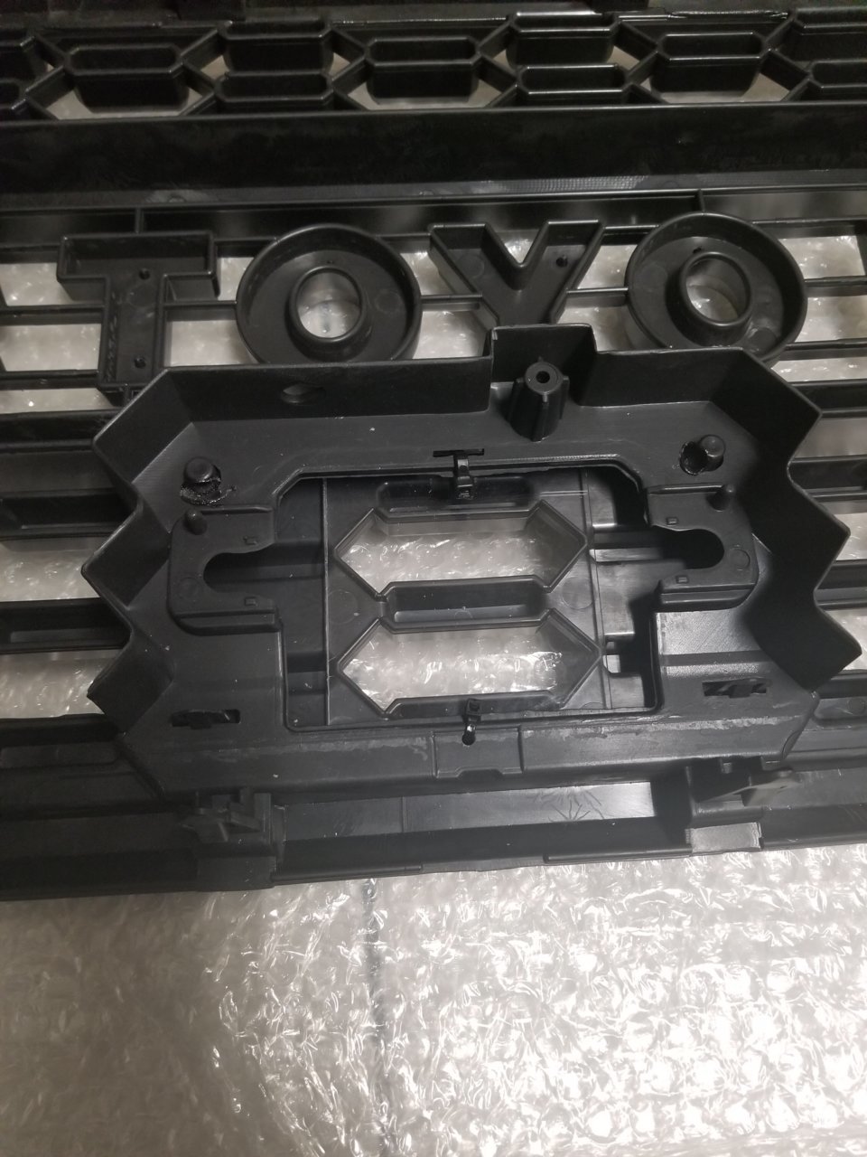

    I don't and there wasn't one but with all the ideas on this thread, it just lead me to do what i did. Got plexiglass from lowes, they sell sheets (8x10), cut only to cover the holes (size 3.25x3"). Once i knew the size i wanted, just made a cut line and kept running a blade (standard box cutter) multiple times, found a solid edge of a table and then snapped off the piece. Since there was an existing mount point for the factor garish, i figure i just put a hole at the bottom, then zip tie and done. Test drove it this morning. No errors or lights, both early braking and active cruise controls as normal.

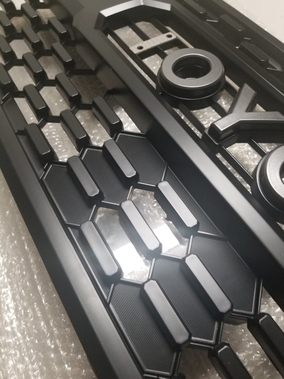

    From looking at the pictures of the OEM garnish and pictures of the grill, i think the sensor warning is likely due to the raised triangular/rectangular plastic pattern vs the garnishes flat surface. i assume the uneven surface is attenuating the signal?

    Using the same piece of plastic as last time, I was comparing the Sport grill to the new one and noticed that there is much more space between the plastic T logo on the Sport grill than there is on my new TRD non OEM grill. I went ahead and pulled the sensor, and added some nylon spacers to the mount screws. I made it 10 miles down the road before I got an error (as opposed to down the street) and it flicked off again a few miles later, and then back on a few miles after that. I think it's safe to say that distance is making a difference in my case.
    As for the errors I'm getting now, I noticed my plastic license plate piece is a little wiggly in there. It seems as though the people who have had no problems were using silicone or some sort of permanent bond to keep their plates from moving. Guess what I'm doing tomorrow? Will report back.

    I have it, doesn't look like actual glass. My guess is polycarbonate or something like that. It has to withstand the force of being out front from daily use.
