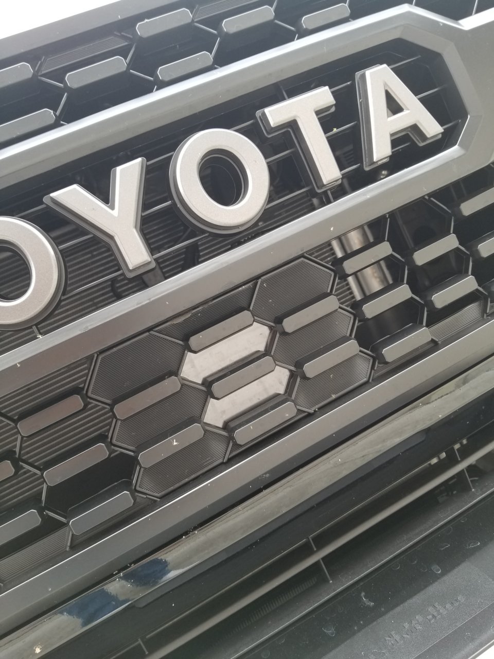

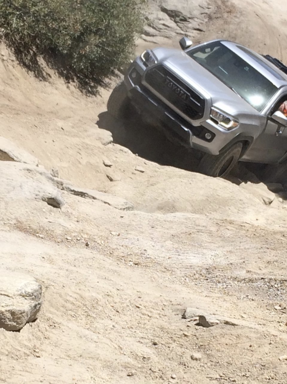

    I bought a $119 eBay grille without a garnish a couple months ago and moved my sensor down with no lasting issues. The first 500 miles every once in awhile it would go off, then restart up. Recently I tackled this hill and knocked out my alignment and my traction control light wouldn’t go off after the alignment. The dealership did a free zero reset calibration (it was called something like that) and they said it reset all the parameters of the motion sensors in the truck. They said it included the front sensor and it always works great on the highway. I wish we could default the distance setting to minimum automatically when you fire it up the radar. The 3 click distance is so far back everyone cuts in front. Then I honk :)

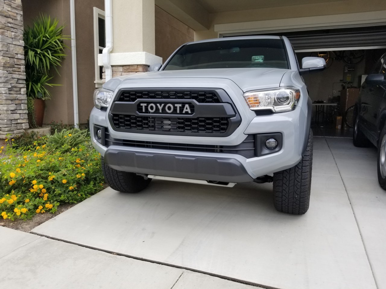

    Humble Soul, I had the same issue when I first installed my eBay Chinese TRD Pro Grill. However, the alarms went away after my first three freeway test drives. 2000 miles later, I'm still error-free. I installed a piece of plexiglass on the inside of the grill to cover the TSS sensor. All said and done, the entire set-up cost me around $100.
