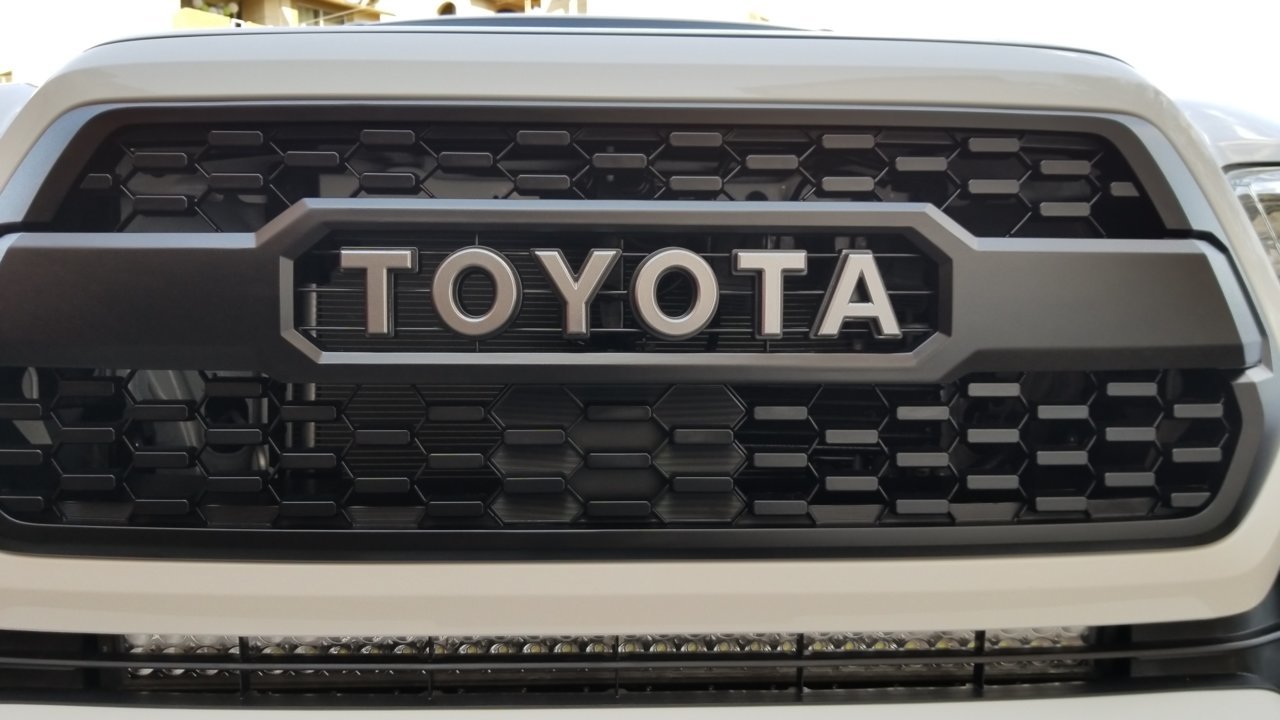

    Just installed my Chinese Grill and OEM garnish Only trouble I had was with the harness clips, eventually got it tho. I have the cover off the grill do people buy those, if so how much usually?

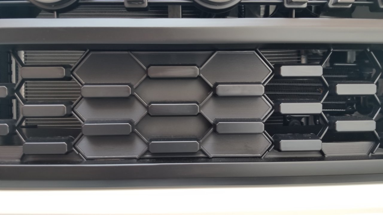

    I installed my non OEM 2018 Pro grille over a week ago. The TSS sensor fit perfectly with the original screws.
    I initially drove without any cover to protect the sensor and I would get the "clean sensor" warning every couple miles on the freeway.
    Then, I got my hands around a black piece of acrylic, cut it to fit the space in front of the sensor and used double sided tape to get it in place. I have used cruise control 4 times now without any errors. 20180808_161718.jpg 20180808_161723.jpg

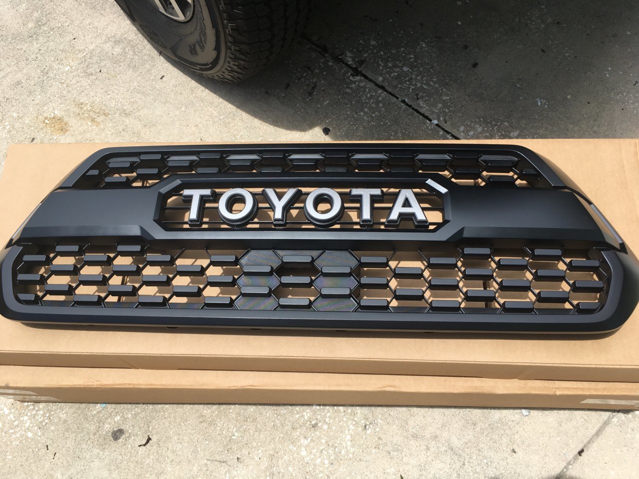

    2018 OEM Grille.
    Thanks @cruiserhead for shipping out the ‘17 OEM Garnish :cheers:

    Looks like it cleaned up well. Good luck!
    Soul Surfer[QUOTED] likes this.

    Yup, worked perfect! Thanks.

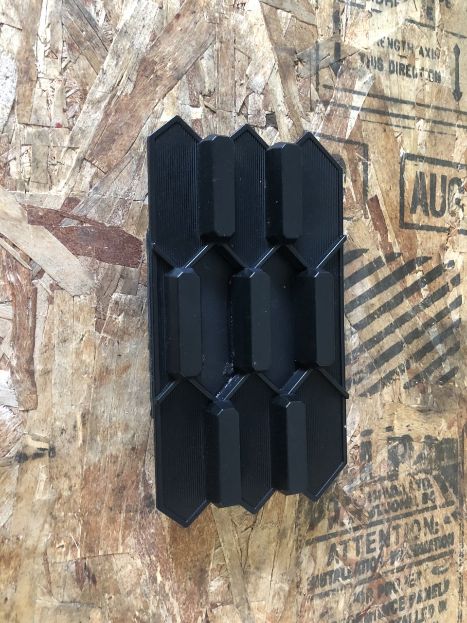

    Even though I purchased the OEM garnish, I wanted to see if I can use a piece of black plastic in it's place so I cut up an extra glove compartment organizer I had and glued it on to the grill and it works perfectly. No error messages, adaptive CC works, pre-collision works for the past 2k miles. I still have the garnish sitting in my garage just in case the truck starts throwing TSS errors. My main motivation for not using the garnish was that I wanted something that is not as shiny as the garnish.
