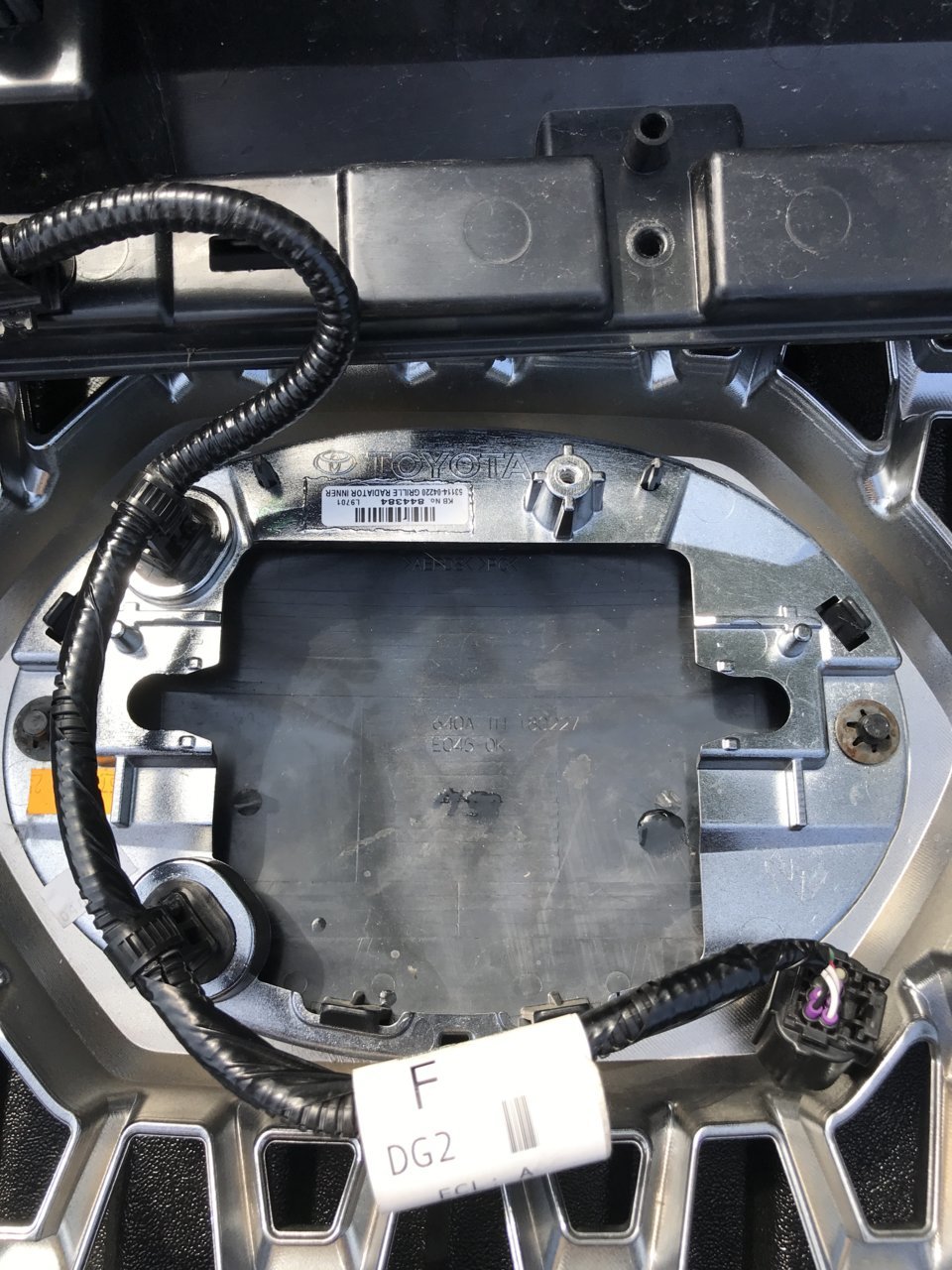

    Okay, I am probably retarded but completely at a loss... how do I remove the two clasps connecting the TSS wire to the front sensor??
  12. Aug 17, 2018 at 8:22 AM
    #952
    SC1978
    SC1978 Well-Known Member
    Oct 24, 2017
    #233955
    122
    NOVA
    2017 Tacoma SR5 DC Black
    it pulls out. use flat head to get it going. thats what I did.

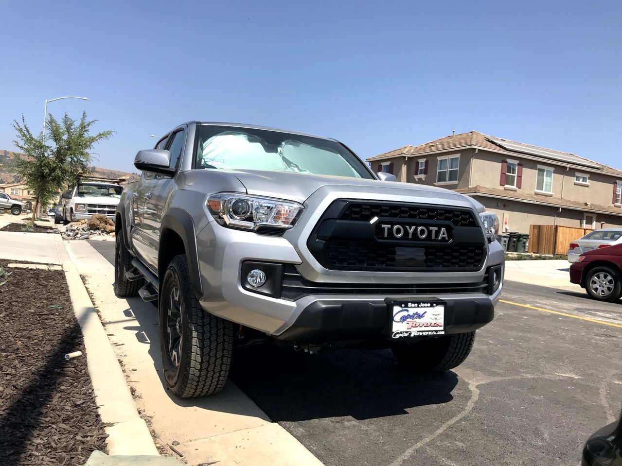

    Just made the swap! Couldn’t have gone smoother. Paid $70 for the OEM one at the dealership only because I didn’t want to wait for the other to ship. The grille itself was $120.
    LOVE IT!!!

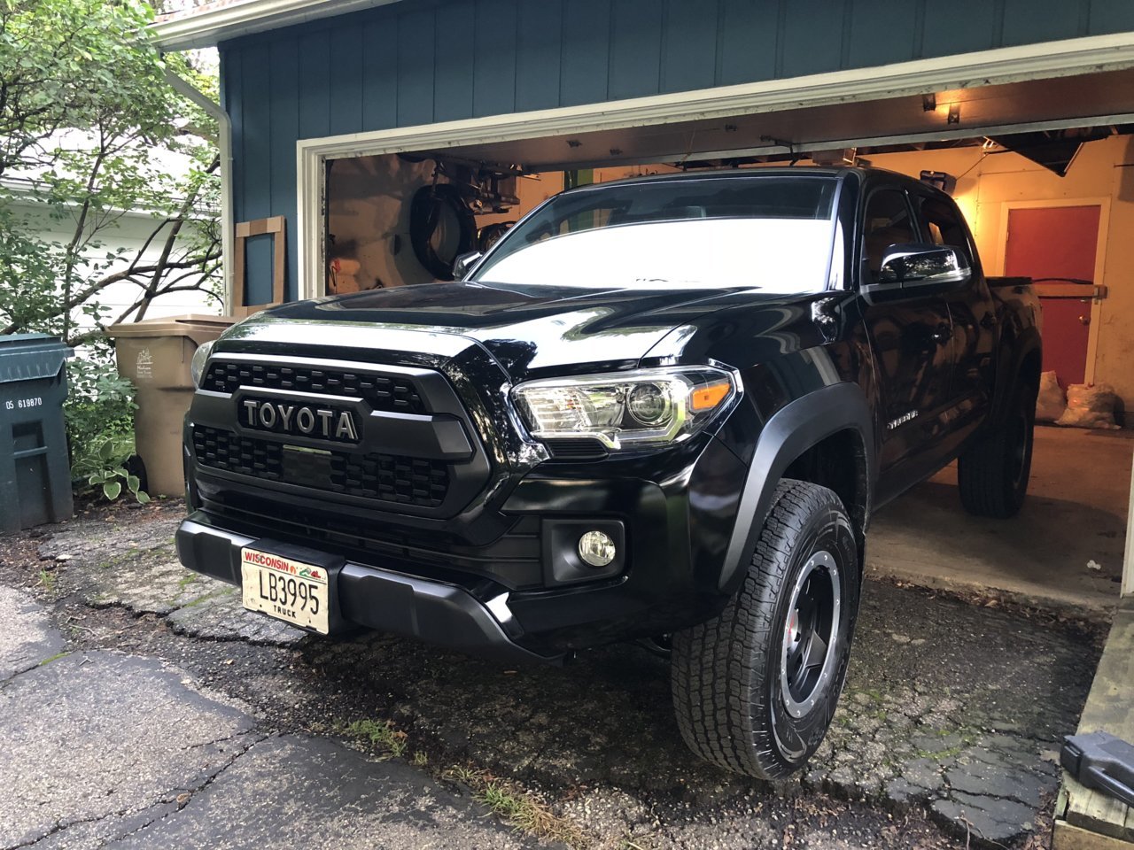

    I'm a little late to this party, so apologies if what I'm about to ask has already been covered.... I just purchased a 2018 TRD Sport (not lifted).... Its sensor sits in the Toyota emblem on the factory grille....
    I just purchased an after-market Pro grille and the sensor is seated lower on the Pro grille than that of the stock grille.... Will it cause any issues? On the factory grille, it sits dead centre, but on the Pro grille, it sits just beneath center.

    Yes, your sensor will work just fine.
