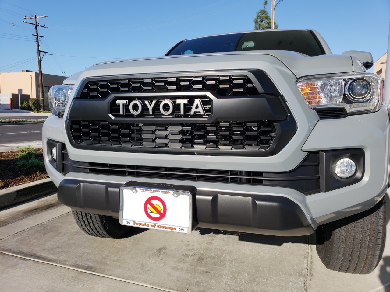

    Tailgate letters.
    Thank you!

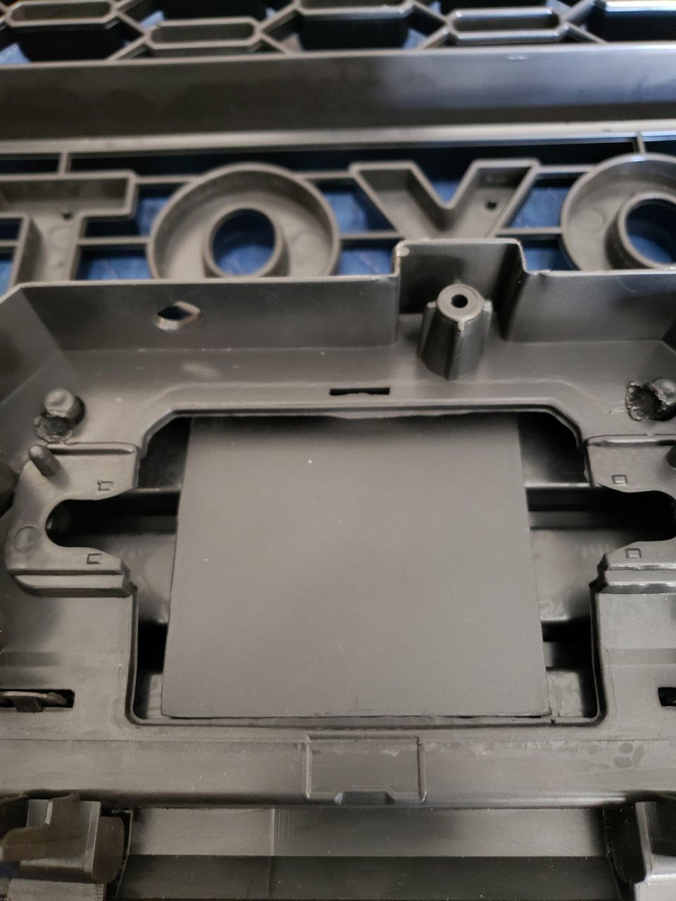

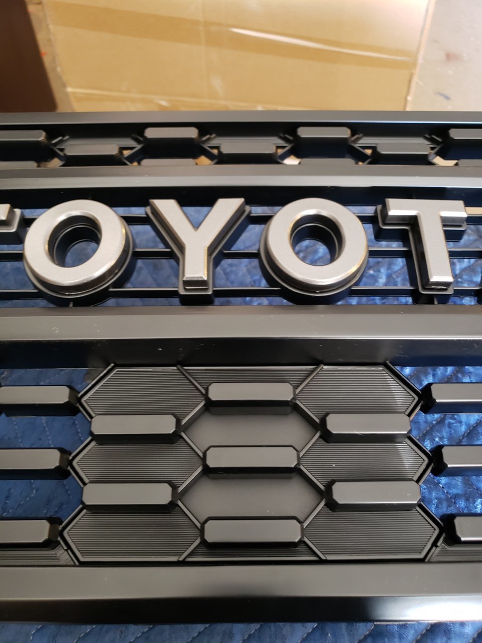

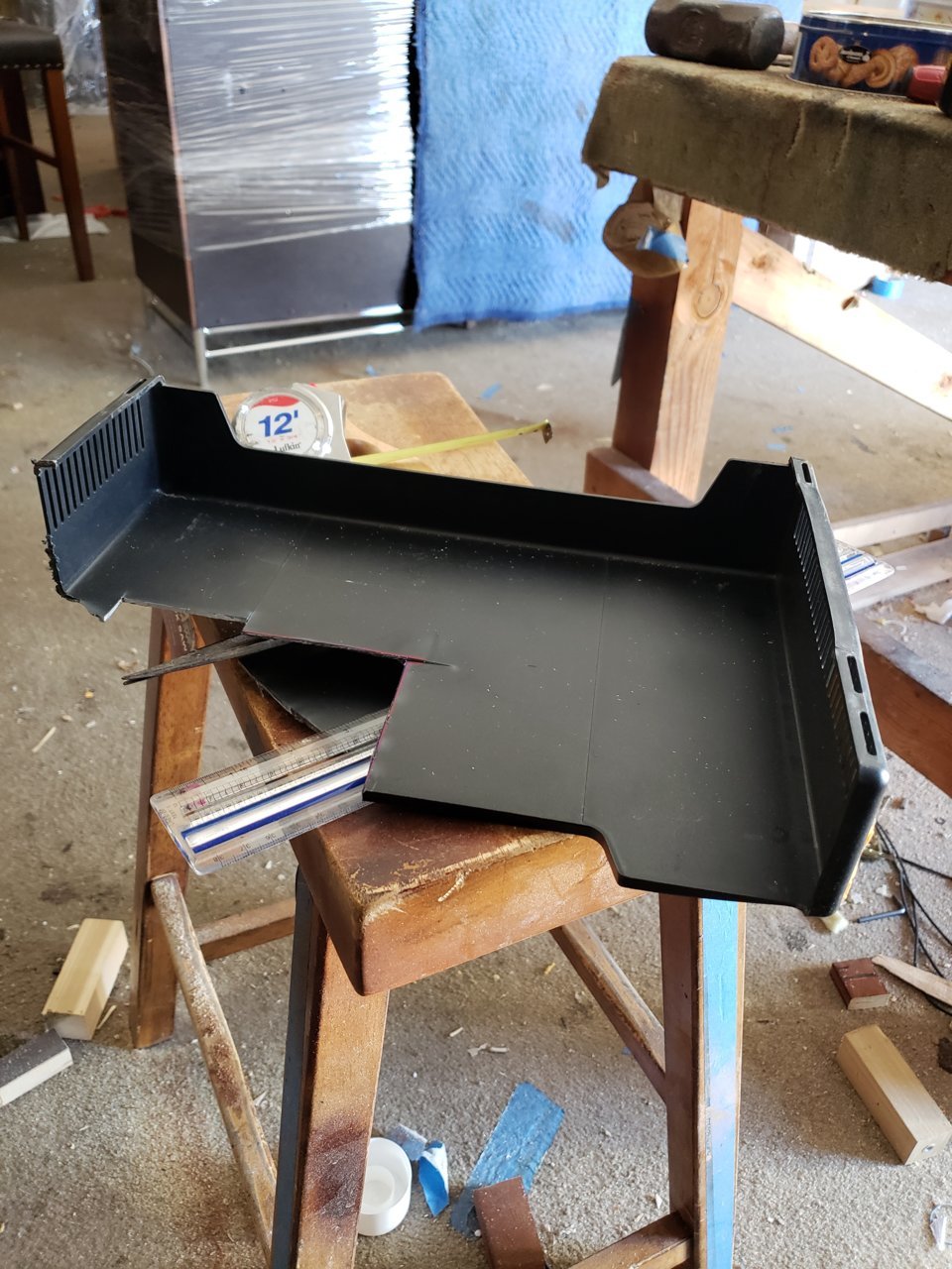

    Just installed a Chinese pro grill last night on my 2018 TRD OR. I'm not a fan of the OEM garnish so I went the DIY route. Instead of cutting up my license plate holder, I used an old plastic paper tray I had laying around in my warehouse. I cut a 3" x 3.25" piece from the paper tray, spray painted it flat black and super glued it to the grill. Drove to the gym and back this morning (~ 6 miles) and so far no error messages. I tested the lane departure and that worked fine. I didn't get a chance to test the pre-collision system but will report back if it doesn't work properly.

    How do you guys even glue the plastic piece to the grille? Not really a flat surface there.

    Just brushed some super glue on the edges of the open hexagon where I attached the plastic cover.

    Silver 2018 TRD Sport - LB
    Tailgate letters.
    Looks good!
