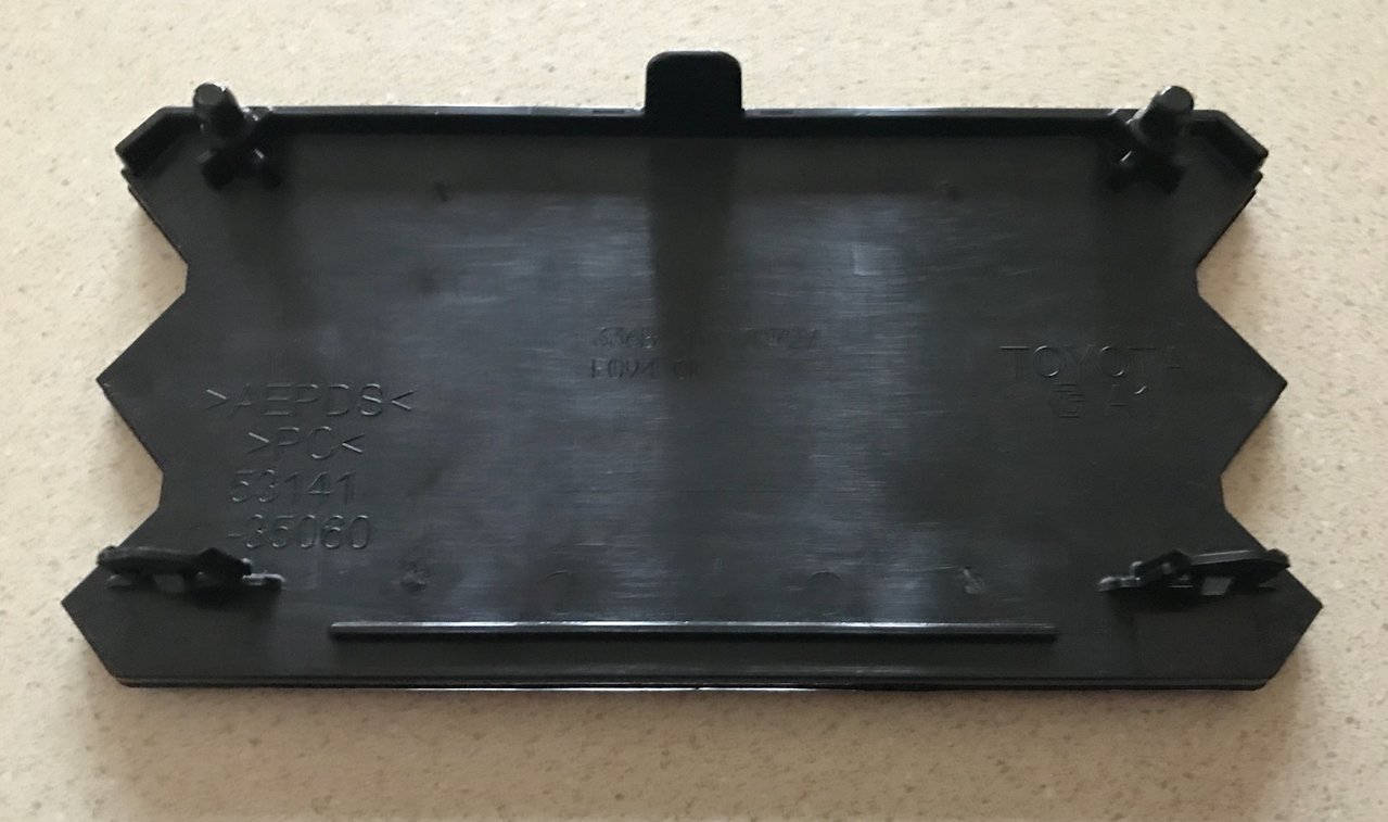

    I just installed my '18 Grill with garnish and didn't use these. It appears to just snap into place. Did anyone use these?

    My 18 Garnish wiggles in the grill slightly. I didn’t use the fasteners and didn’t notice how they would work. Anyone have pics? I just popped it in and then used the 3 screws and the two square slip on nuts to secure the radar unit

    There are clips that hold it in, but with out the fasteners there is nothing to keep it there. I am guessing it won't fall out, but you could probably hit a bump just right and dislodge it. For .50 it is worth the peace of mind to not have to spend another $50 to replace it.

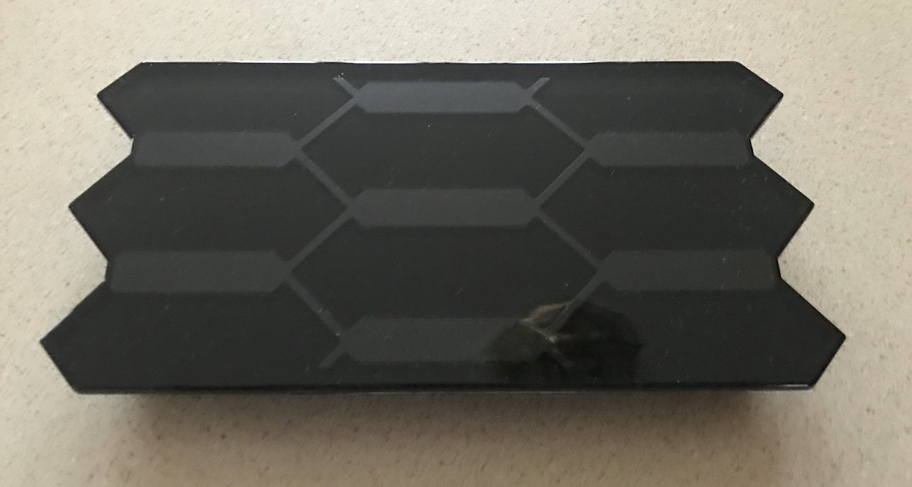

    I installed mine yesterday in my garage during the snow storm. Used my 2016/17 Pro grille with a garnish from Camelback. The angle of my photo makes the garnish look shiny but it mostly does not show. And it works perfectly.
    The garnish is NOT glass, it’s plastic. See my photos in #51 above

    Just ordered the starlock fasteners. Does anyone have the part # for the shorter pop rivet located on the lower left and right in this photo? When I popped out my right one it fell and I lost it.

    Nevermind I think I answered my own question. Luckily Toyota uses the same parts on all of their cars, makes it easy. This appears to be the part, I'll confirm once I receive it.
    Shorter pop rivet (lower) Part #
    90467-08217

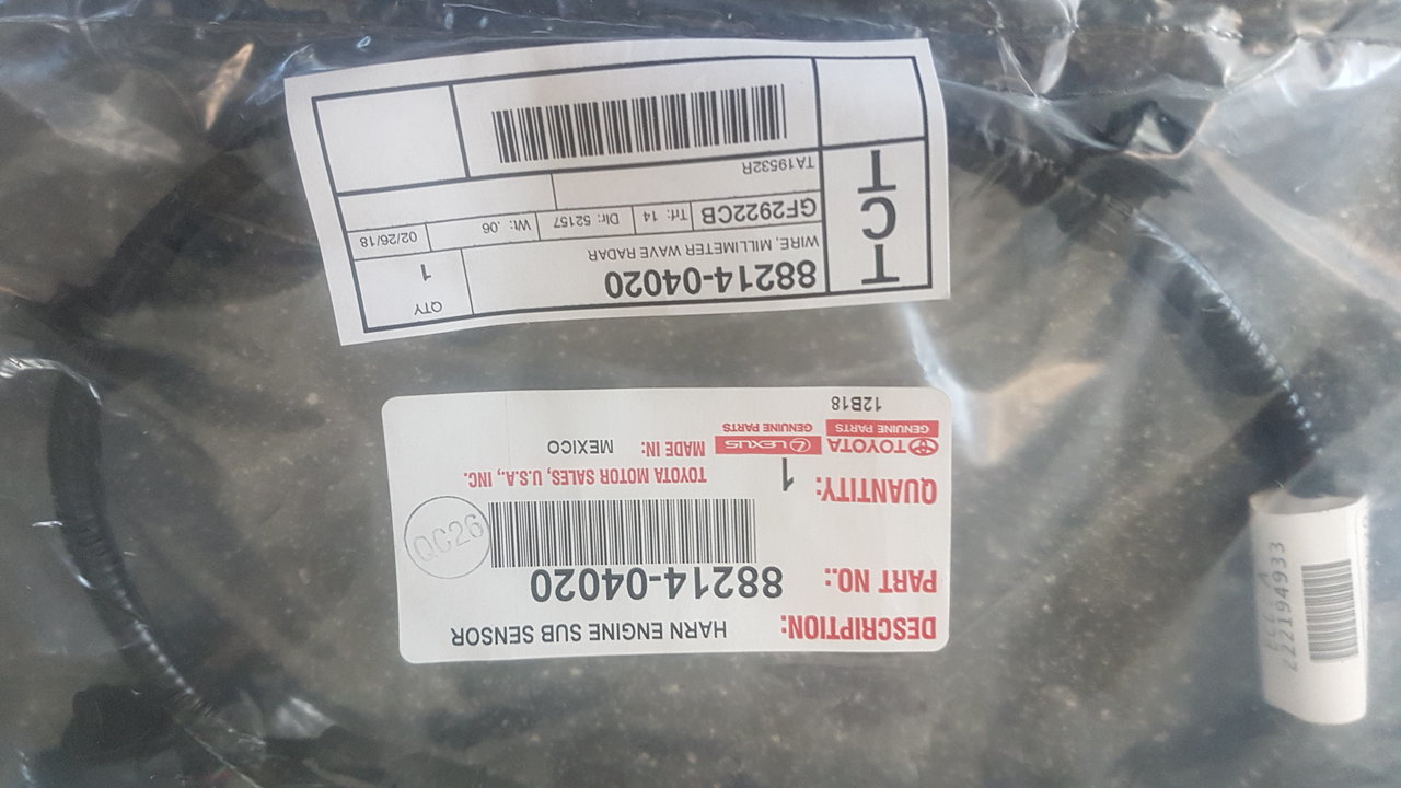

    The stock one will work but has to be routed in a way that you can see the harness through the grill. I ordered the 18 harness and I'm installing it today.

    Used original harness. Not visible through grill...

    For me it's not visible (to me) but the cable barely reaches so I might order the new harness.
    Did the harness come with the zip ties with the little rubber notches that click into the grill already?
    53141-35060
