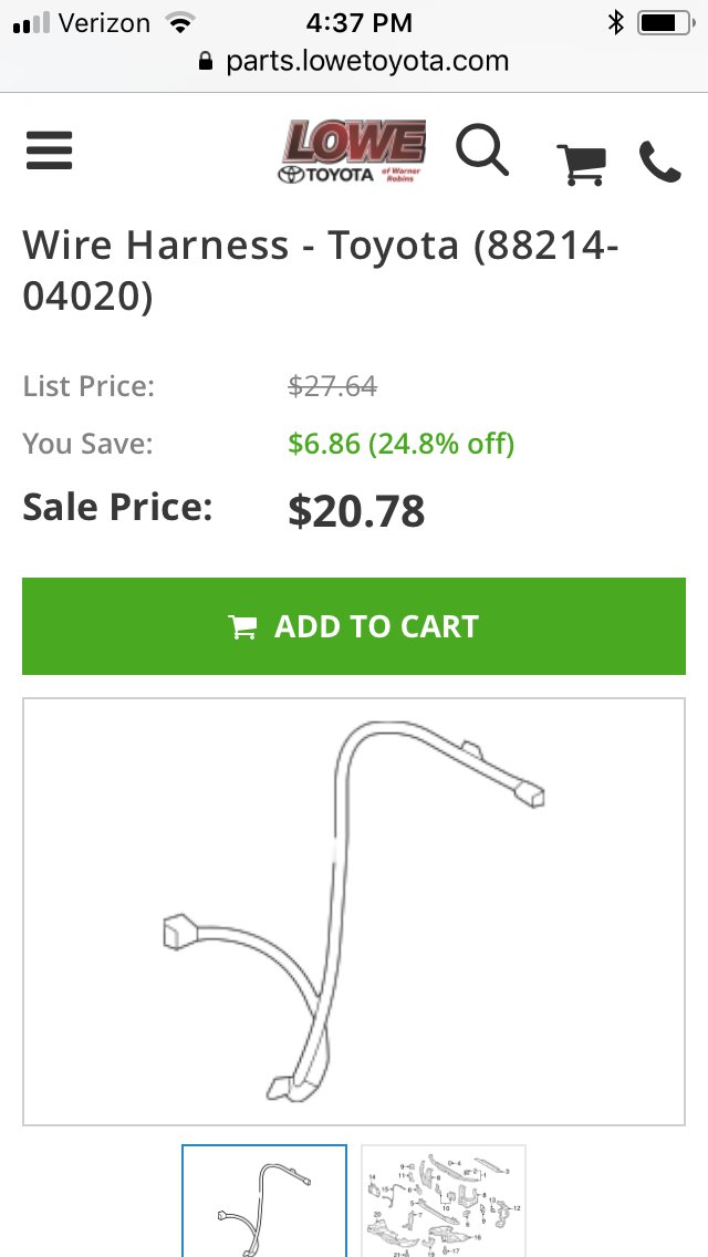

    Does anyone have a part number for the longer wiring harness? I've been looking around and can't seem to find it.

    88214-04020

    Thanks man. Just ordered.

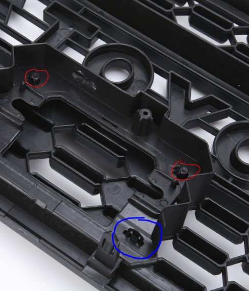

    Will you tell me if the sensor housing looked like the photo below please?
    Also, did the letters come on a separate bracket that mounts separately or did you have to stick them on?
    Thank you.

    Yes that’s how mine looked. You can push out that center piece to put in the OEM garnish. The letters come separate with double sided tape so all you have to do is apply the tape and push them on.
