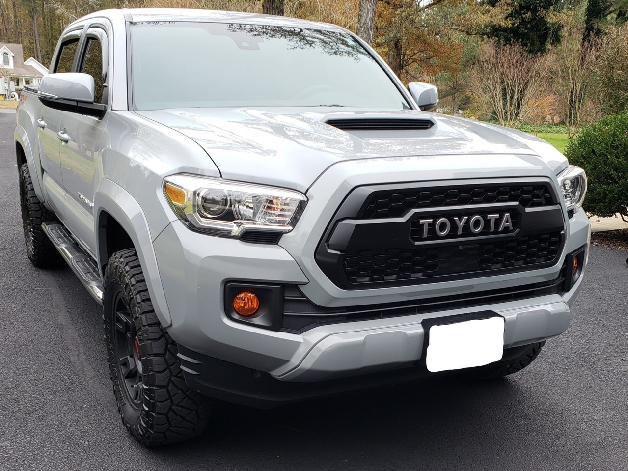

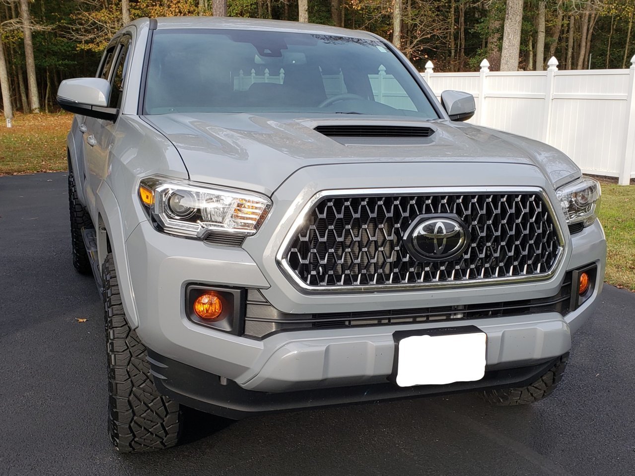

    Mine was a PITA. I took my time and still ended up breaking a few on both the outer chrome trim piece and the grill itself. After I got a few popped out the rest started to release pretty easily. Oh well, don't plan on putting it back in.
    Before and after below. The new wiring harness was worth it IMO - it comes pre-assembled with the plastic strain relief clips that perfectly align with the routing channel clip points on the TRD Pro OEM grille. No sensor errors yet, drove it for awhile today and tested cruise control. Difference in mounting height on the sensor between the two is approximately 4" (mounting location on non-Pro grille is 4" higher).

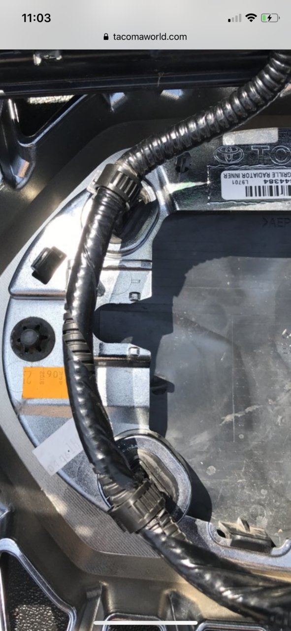

    Does anyone know the part number for the clips that hold the TSS wire into the grille/back of the stock sensor housing? AB94BD53-A02C-4DBE-93DF-54D5E679C5C4.jpg
