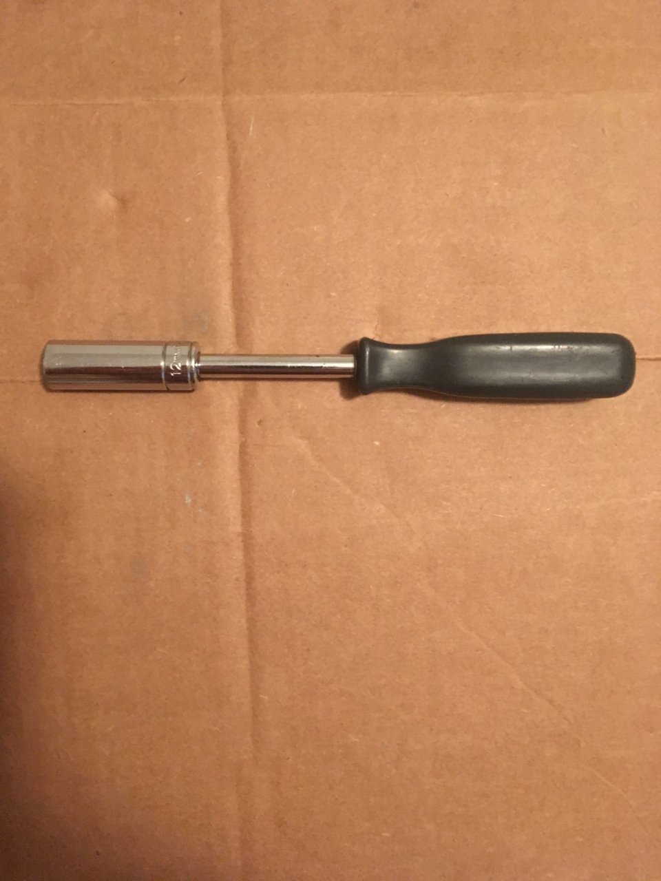

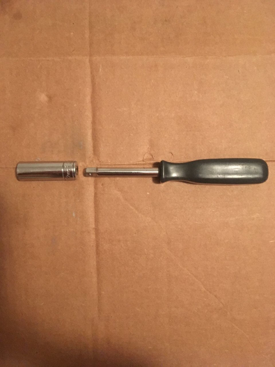

    Can someone dumb it down for me, using the star lock tool? Sorry noob status

    The video is just an example, and one of the ways to show how to Install them by pushing them on. Like mentioned you can use a deep 1/4” drive socket with a nut driver. You don’t need to buy the tool.

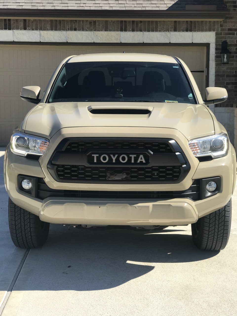

    HouStonTacoSupreme
    HouStonTacoSupreme Active Member
    Nov 2, 2018
    #271410
    32
    Shawn
    2019 Tacoma TRD Sport quicksand
    I just got my trd Pro grill ordered from Toyota parts factory it’s a dealership in Arizona I believe, just gave a trd Pro vin and ordered online 230 shipped with the garnishB4B5723B-3473-4E56-86B8-DD924E35FE30.jpg
