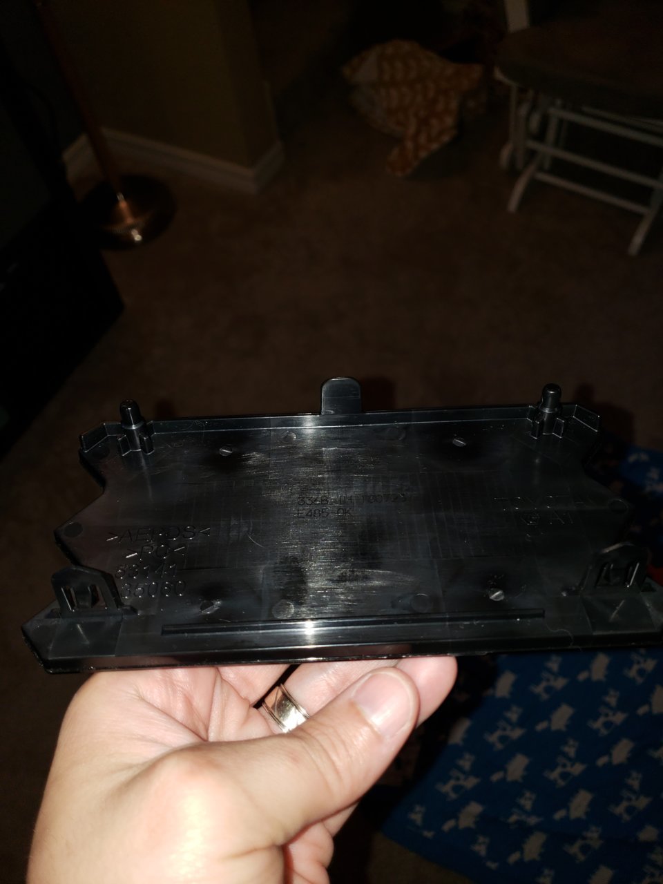

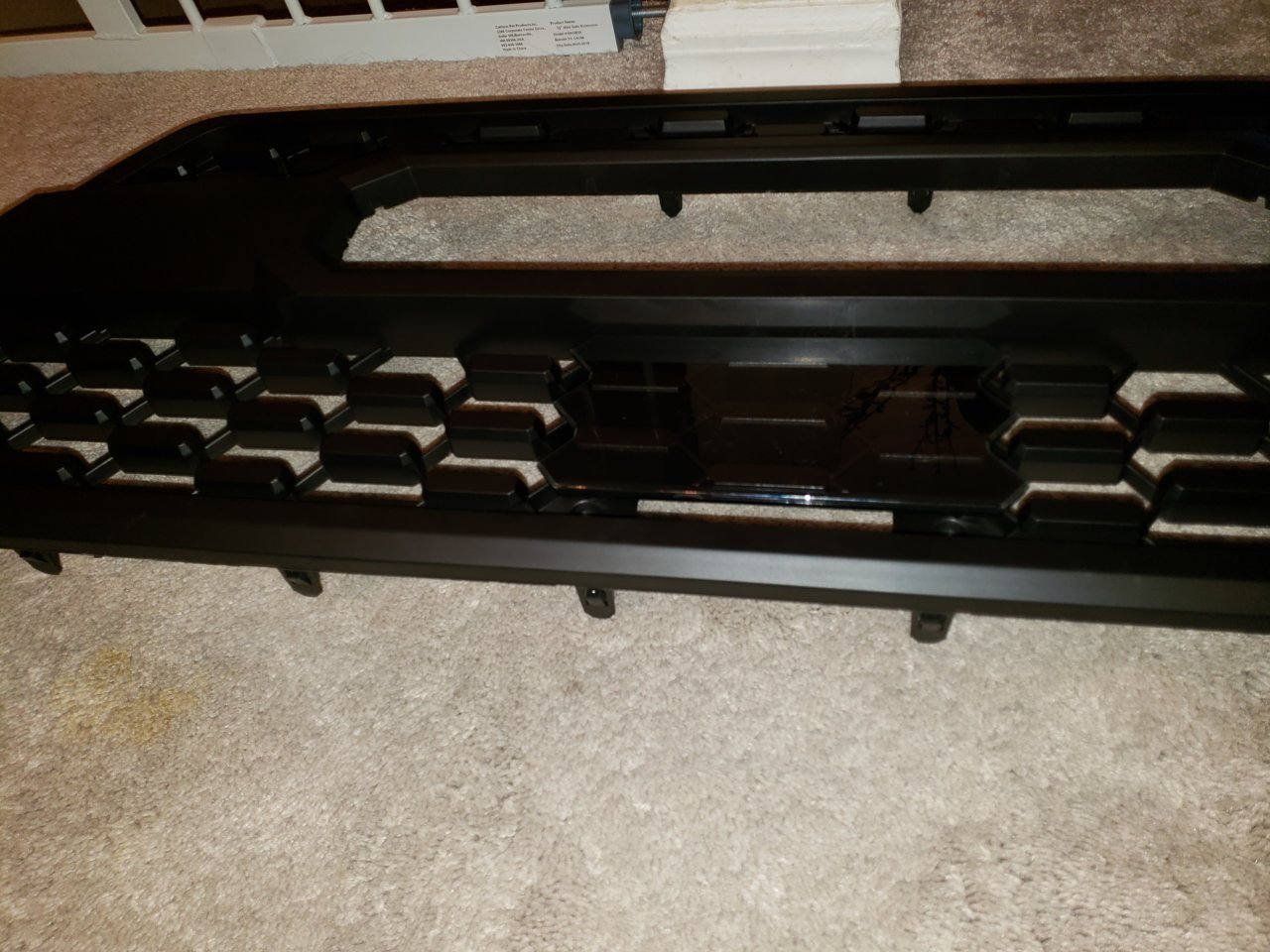

    So bought the faux grill and garnish for xmas gift, but the grill doesn't have the slots to slide the garnish. Anybody have this grill version and what was your work around if any?

    Correct me if I'm wrong, but if I remember right the garnish should have pegs that slip into the four holes which then screw into the back?

    Won't fit bc tab slots aren't on grill.

    Can you post a pic of front grill with garnish sitting over where it needs to go?

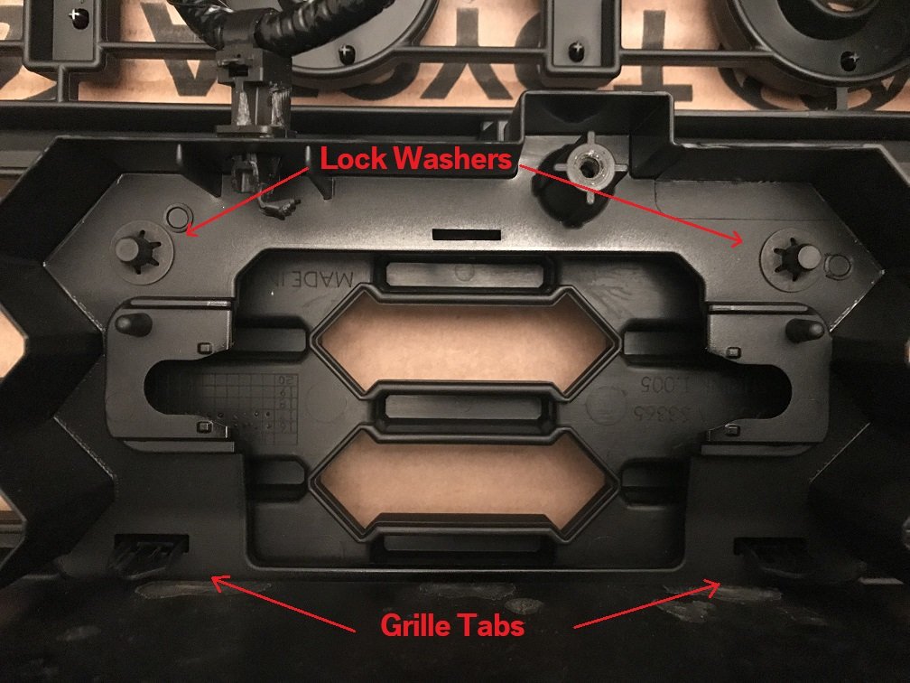

    This was taken from a thread here on tacomaworld and mirrors the grille I installed. In this picture of the grille, there's slots for the tab entry. Sorry I couldn't be more help but it looks like an issue obviously of yours didn't come with the right inserts.

    Awesome. Looks like I'm chopping tabs and gluing on

    So garnish looks like it will fit am I correct? If so I would mark where you need holes or slots in the grill and just drill them. Or snip off the tabs on the garnish and just use clear silicone adhesive to mount it. You will never need to remove the garnish so should be fine

    Yup, that's what I was thinking
