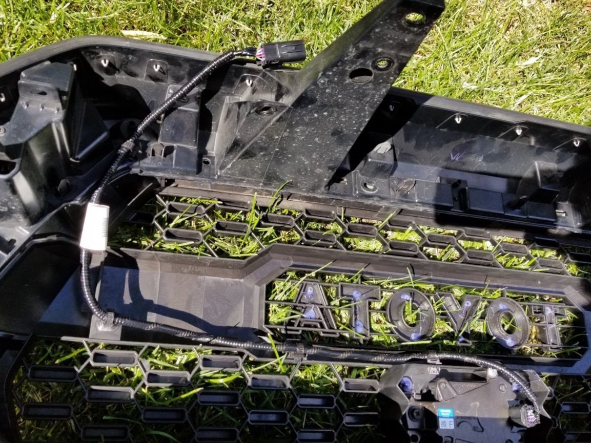

    Does anyone or this thread have a picture of the longer harness routed in the grille? I too am wondering if it’s a waste and why needed.

    I didn’t find it a waste ... it’s only $20 and fits the new grill perfectly ... all of the clips are exactly where they need to be and the harness routes so that it’s not visible from outside the grille.

    Do you happen to have or know where a picture is if the routing? I’m going to be installing it all soon. Thanks

    The longer wire harness clips behind the grille, runs horizontal behind the center piece and around to the top of the grille, making it is less visible when looking through the grille. Refer to the photo below.
    On the other hand, the standard length wire harness runs vertical from the sensor to the top of the grille, leaving it visible when looking through the grille. If you take a look through non-Pro grilles, especially the ‘18-‘19 Off Road and Sport models, you’ll see plenty of visible components.
