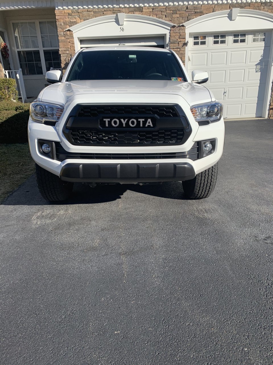

  12. Feb 11, 2019 at 9:32 AM
    #1372
    Arcadebrothers
    Arcadebrothers Member
    Jan 24, 2018
    #242288
    19
    Mark
    2018 White TRD Off-road
    HiKari LED fogs, Front tint, Plate LEDS, predator bars, bed mat.
    Just ordered an OEM from Pinehurst Toyota because they had the most reasonable shipping.

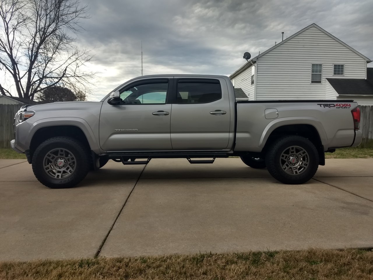

    None, finally back in a Taco
    Can anyone with an OEM pro grille installed show me some side profile shots? I double-checked the clips are all fully inserted, but I feel like my grille is sticking out way further than the images I am seeing on this thread. Need some reassurance here!

    Thanks mds08. Could you get a closeup side profile of the top half? I will show you what I mean with mine when I have sunlight. Your pictures def look more like my alignment though, thanks
