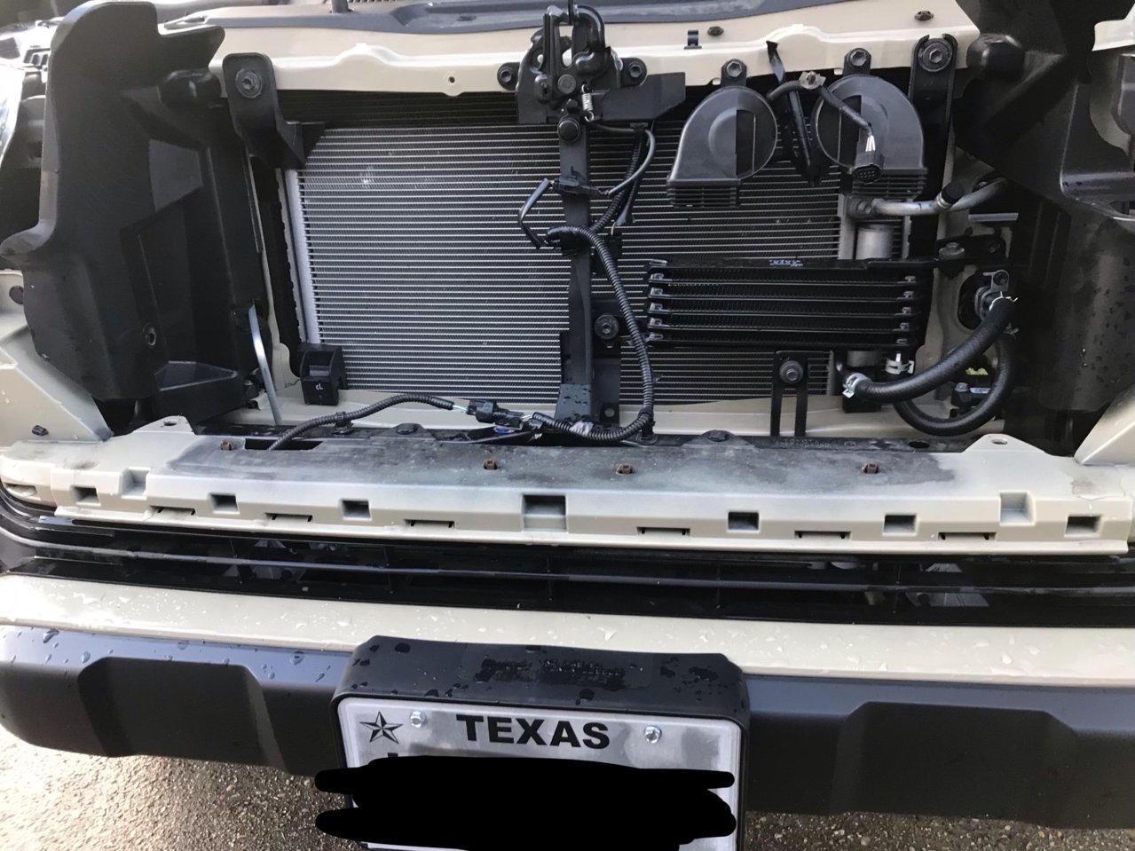

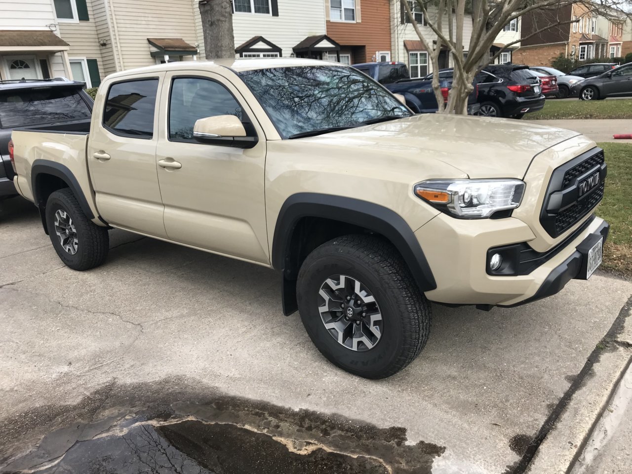

    I triple checked this morning, everything is fully connected. I’m close to just driving by the local dealer and looking at a pro to see if it’s the same. It is probably just perspective.CBC47B7D-4E4F-4899-AAD1-2403F74D4927.jpg F14D481F-66FE-4DC8-914F-6064A3FEBC37.jpg D138AA69-28C7-4E72-8E56-48A01D4B21E9.jpg

    Mine looks the same. The pro grill does stick out a bunch more than the others.

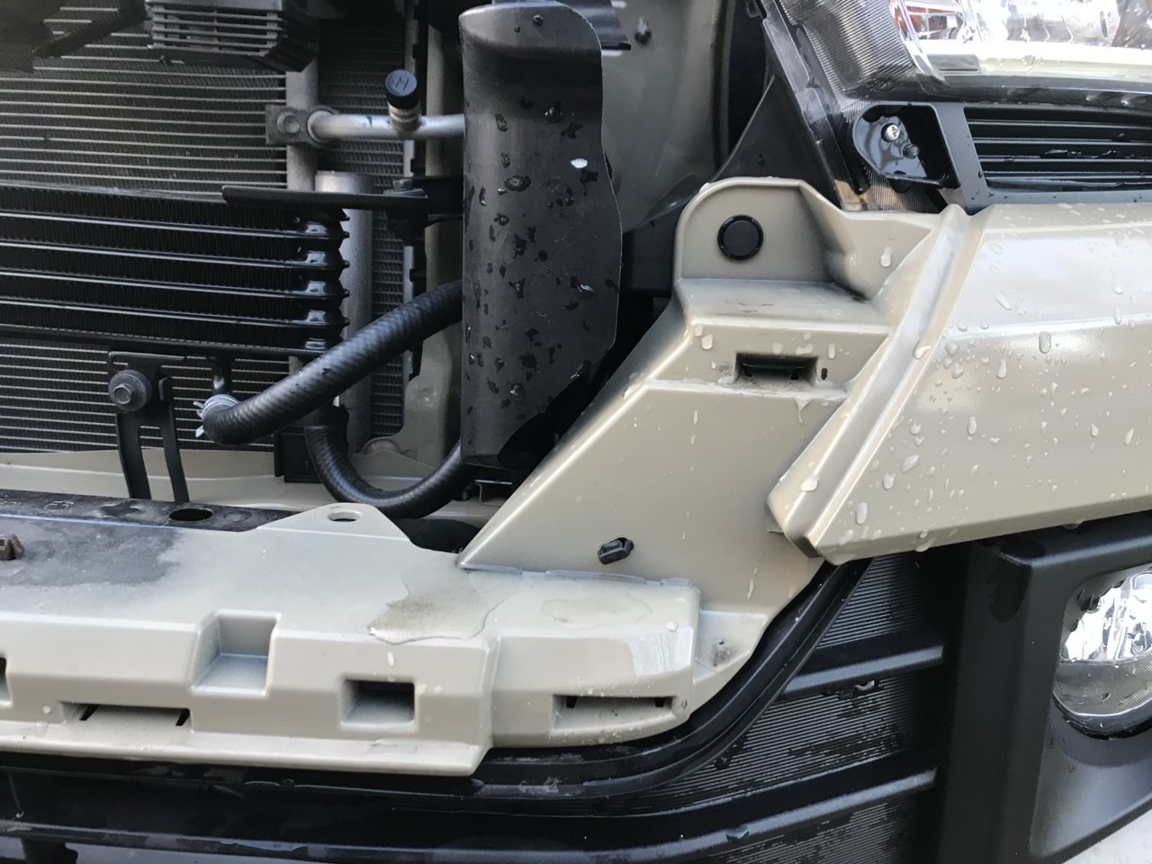

    I was concerned that my grille wasn’t fully inserted, that’s why I was asking to see comparable pictures lol. I was thinking “man, this thing looks installed, what am I missing??? All of these other install pictures seem a little more flush. I really don’t want to remove my front clip again, and I really don’t need this thing to rattle off on the highway. Wes, why did you do yet another mod in the middle of night you dumbass.” To answer your question more literally.

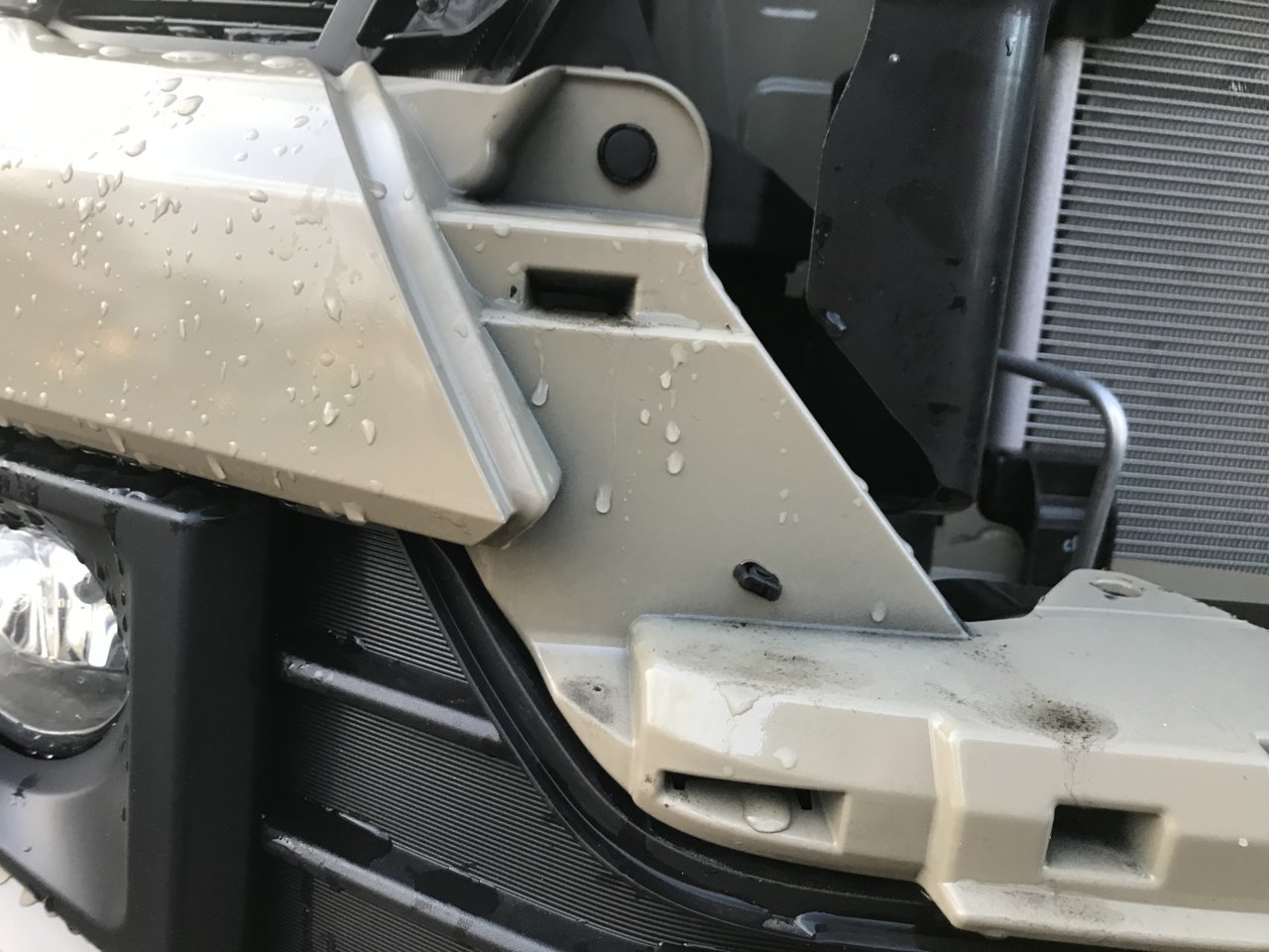

    I pulled mine off twice, they are going in to the slots pictured below, and i feel them seating, just not as snug as factory install was. Let me know what you wind up doing please, I am definitely interested in a fix as well.C727DDF6-F4A8-4EB3-A385-7A56150C2E77.jpg73ED51F2-EC82-42C6-8710-57A1E14647D9.jpg

    Try heating the clips with a heat gun and see if they will expand some. Then cool them down with some cold water to hold the shape. Just a thought

    I misread your post, seeing what I wanted to see. Sorry bout that. My garnish clicked in fine, my grille surround is my loose issue

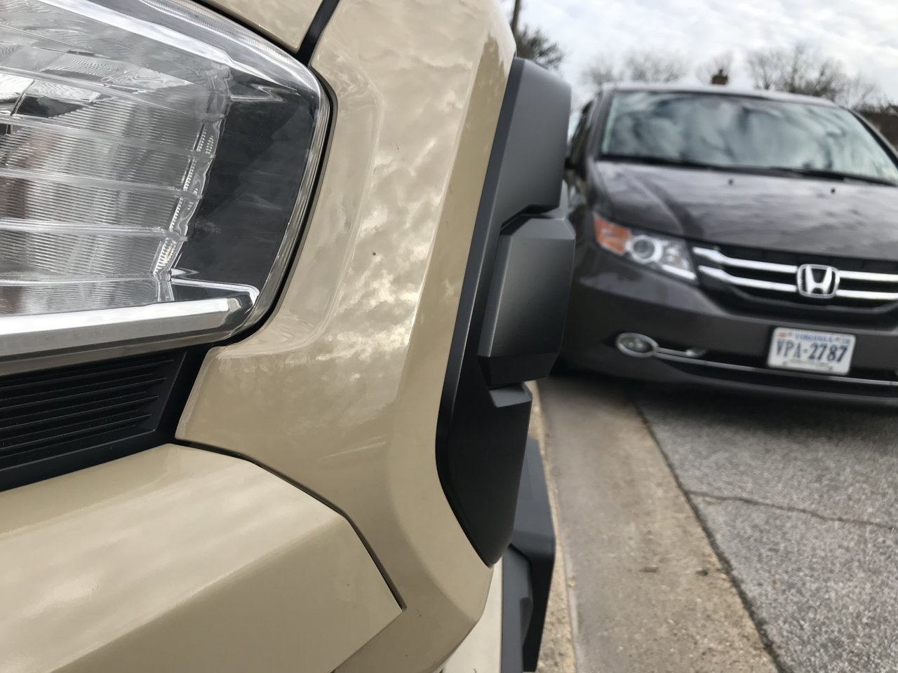

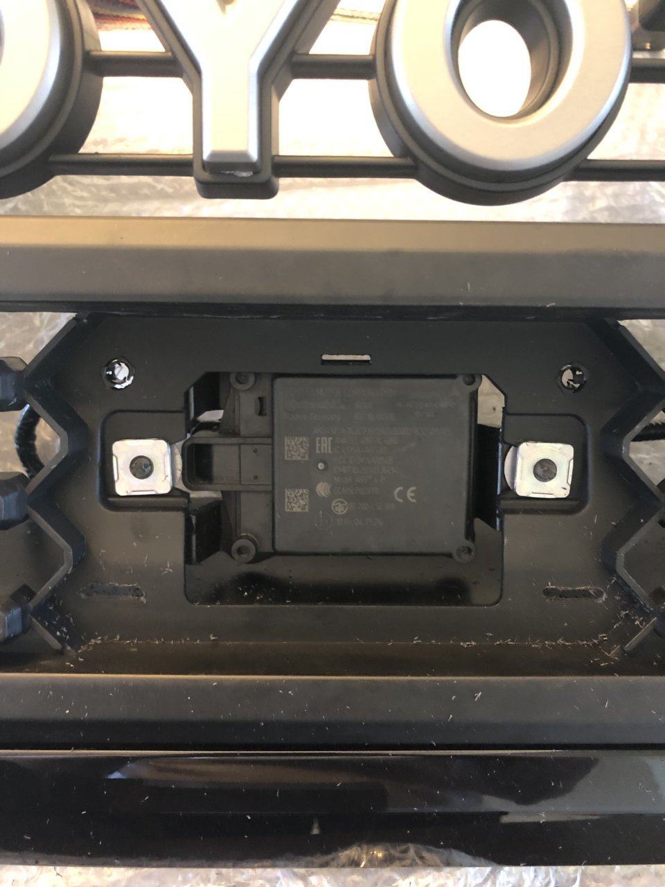

    So I was able to fit the garnish in perfectly. It’s flush now. Had to open up the holes so it can clip since the holes were too small for the clips of garnish. Picture attached.
    The error “Clean sensor Pre collision is disabled” pops up after rolling a few miles. I will drive it a few miles to see if it learns it. All cables are tight. The sensor is clean and tight. The cover is clean and tight. If it doesn’t go away, I will troubleshoot Sunday. So I can put a few hundred miles on it.
