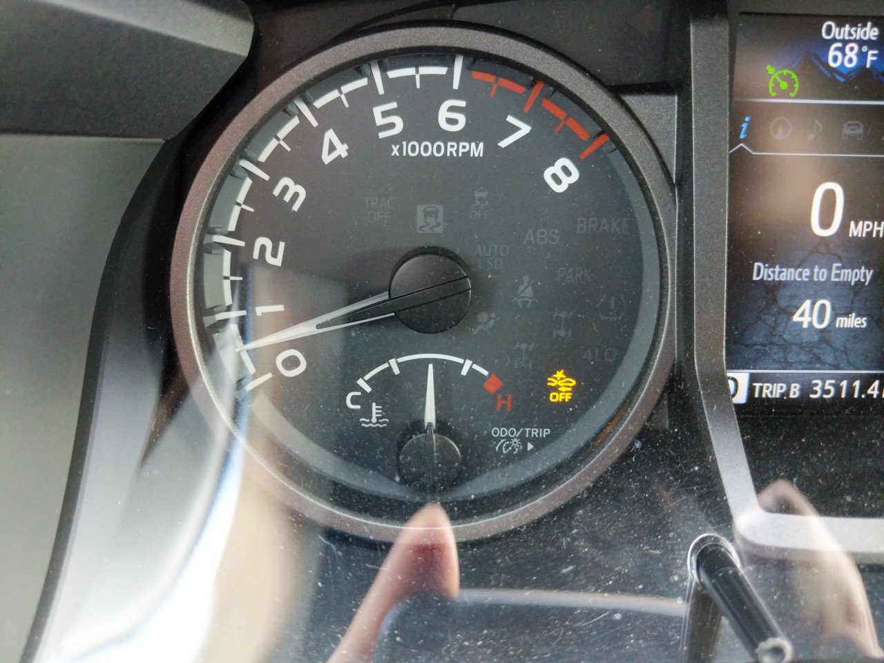

    I got the same grille put on over the weekend. It’s pretty easy, should take no more than 30 minute to an hour. I’m getting an error though (warning icon that front end collision is off). Trying to trouble shoot to see if I can make error go away.

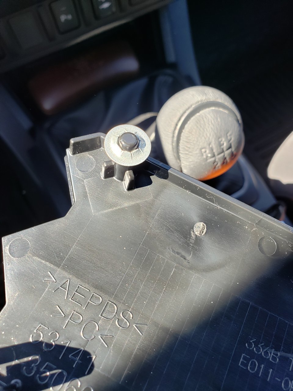

    Currently running Goodyear DuraTracs with "ghetto" wheels
    For those of you who need the push nut washers for the factory TSS Grill Garnish (2018-2019) here is the Ace hardware item. I paid 00.50 cents each at my local Ace hardware store, Midwest Fasteners Item No. 71927-G:
    Beats paying $6-8 off Ebay, Amazon and the stealer ship.
    Tip: Coat each push nut washer with Rust Olem primer and black enamel before using.
