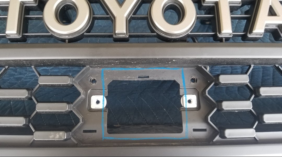

    I have a $72 eBay China grille that I DYI with a piece of plastic I cut from a oil drain pan about a month ago. Errors everyday 10 minutes into the drive like clockwork. Radar CC not working & PCS icon would come on along with the clean sensor message. I decided to try something else...
    Now I have a piece of Kydex cut 4" X 4-1/2" set in front of TSS sensor directly behind the 2016-2017 grille insert & is working perfectly with a lot of testing. I tested the range with the radar distance button on the steering wheel & my truck is tracking distance perfectly. I tested a stationary vehicle turning left waiting for traffic while in radar CC. The truck slowed down from 45 mph as approaching & then flashed "Brake" while turning off CC. Seems to be working perfectly with the Kydex as another member here has used with good results & eliminates the need of the shiny garnish that people are complaining about & will protect the sensor well.
    Here is the dimension I cut the Kydex to fit
