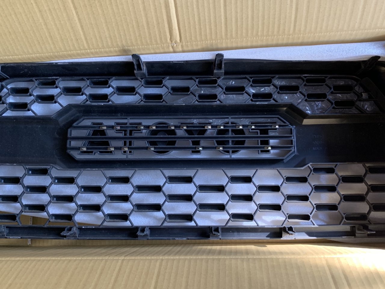

    Sorry if it’s been answered already but I had a quick question.
    I’m coming from a 17’ to 19’ Tacoma. I kept my faux grill from my 17 and wanted to know if there’s an easy way to install the TSS sensor on the older 17 style grill or do I just need to buy one that has the cutout for the sensor?

    Do you have a picture of the back of the grill?

    Here’s the back of the grill

    That is definitely not for a Tacoma with a TSS radar sensor. It would have a opening & mounting holes under the "TOYOTA" letters. Read back several pages & take a look at some pics for reference
