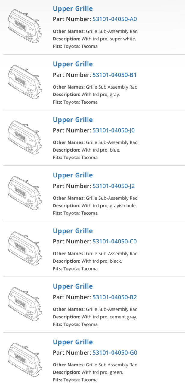

    Another question.... anyone have the part number for the surround? As in, you take apart your old grille assembly, remove the shitty old chrome piece and grille, and put the new grille in... what is the part that you are actually putting the pro grille in? It is painted the same color as your truck
  2. Mar 3, 2020 at 2:26 PM
    #1562
    St0rm-Tr00per
    St0rm-Tr00per Well-Known Member
    Sep 7, 2018
    #265560
    1,266
    SoCal
    2018 TRD OR 4X4 DCLB - Super White
    “Semi-Pro”/“PrOff-Road”
    The “surround” (grille not included) is what you’re referring to and it comes paint matched.
    P/N 53101-04050-A0 (White)
    P/N 53101-04050-C0 (Black)
    P/N 53101-04050-J0 (Blue)

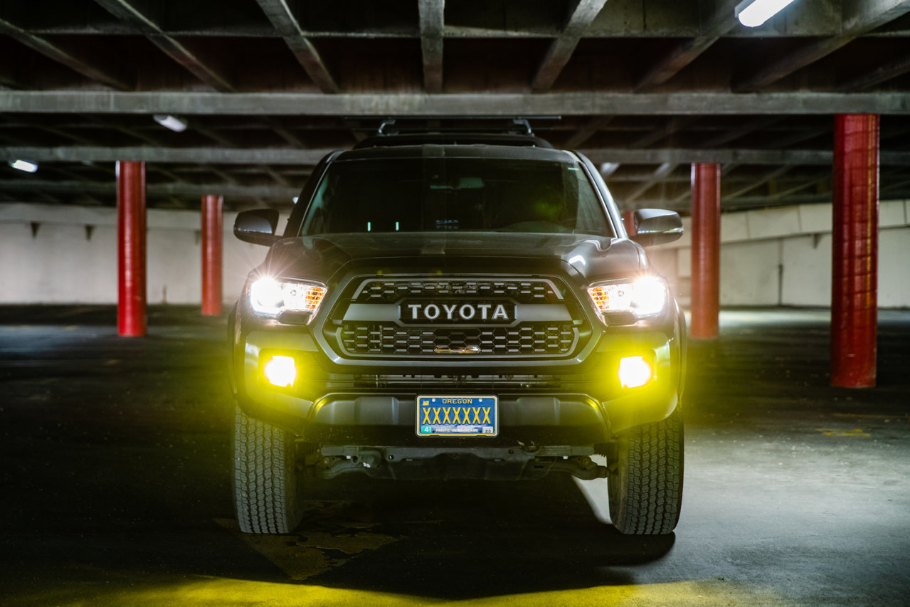

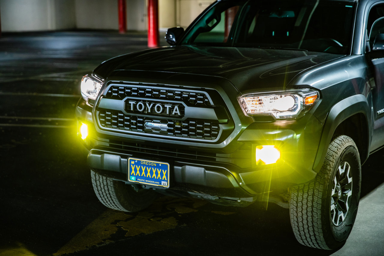

    just installed an OEM grill, garnish, lock nuts, & longer wire harness on my 2019 off road today. paid a bit more than I would have liked, but i'd rather have the peace of mind to know that everything fits & functions as it should...and it does. no error messages or fitment issues. if you're interested in going this route and have questions, i'm happy to try & help. cheers! :thumbsup:
    (no, not my actual plate number)
