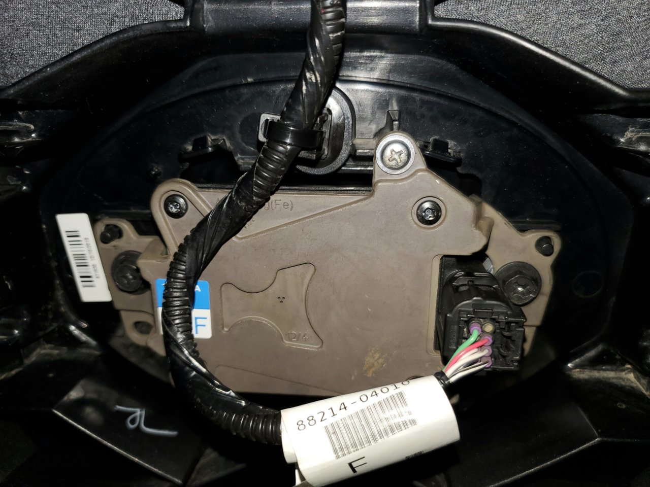

    The pro grille has 3 screws to secure the sensor too . There are 2 factory slide-on metal clips that the other 2 screws thread into on the OEM grill. These clips need to be removed from the old grill and put on the new grill, then you reuse the same screws.

    No prob. I put one washer about the thickness of a dime under the sensor (top screw) to angle it upward just a bit (I read that seemed to work the best for most people), and I haven’t had any issues with my TSS. I’ve been driving around in heavy rain and snow the last 2 days, and using my cruise control here and there with no alerts or anything.

    Amazing how things turn out when you use the correct parts to do the job. The two nuts are on and that sensor is not going anywhere. I took your advice and added a thin washer to the top screw, see how that goes. The rapter lights are on and shining bright. Picture to follow.

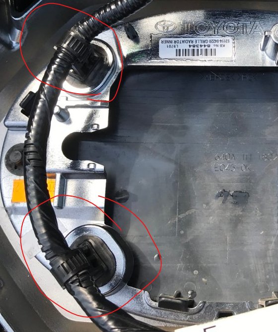

    I was able to reuse the one I clipped off by threading a new zip tie through the slot. Looks like it should work and keeps the wire hidden.
