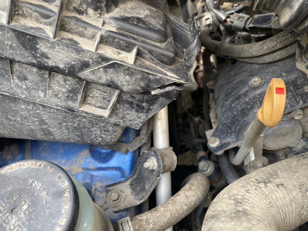

    This definitely seems like a reasonable move. My air filter box looks like it’s not totally closed, is that something that could also be affecting this? Or is this a normal appearance? I think I’ll replace the maf regardless, but wouldn’t mind a second opinion on the air filter box!

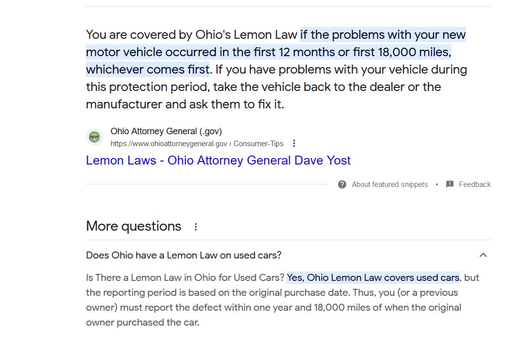

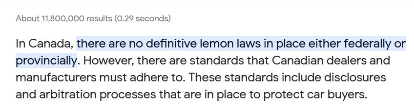

    well I guess a message for ohioans. Something Ohio does better than Canada. Which honestly 100% shocks me

    That’s how it is.

    Consumer protection of any form? In Canada? Hahahahahahahahahahaha

    Before replacing MAF, test it (see parameters below).
    Open air box only affects the air filtration and won't affect the engine performs because the issue before MAF.
