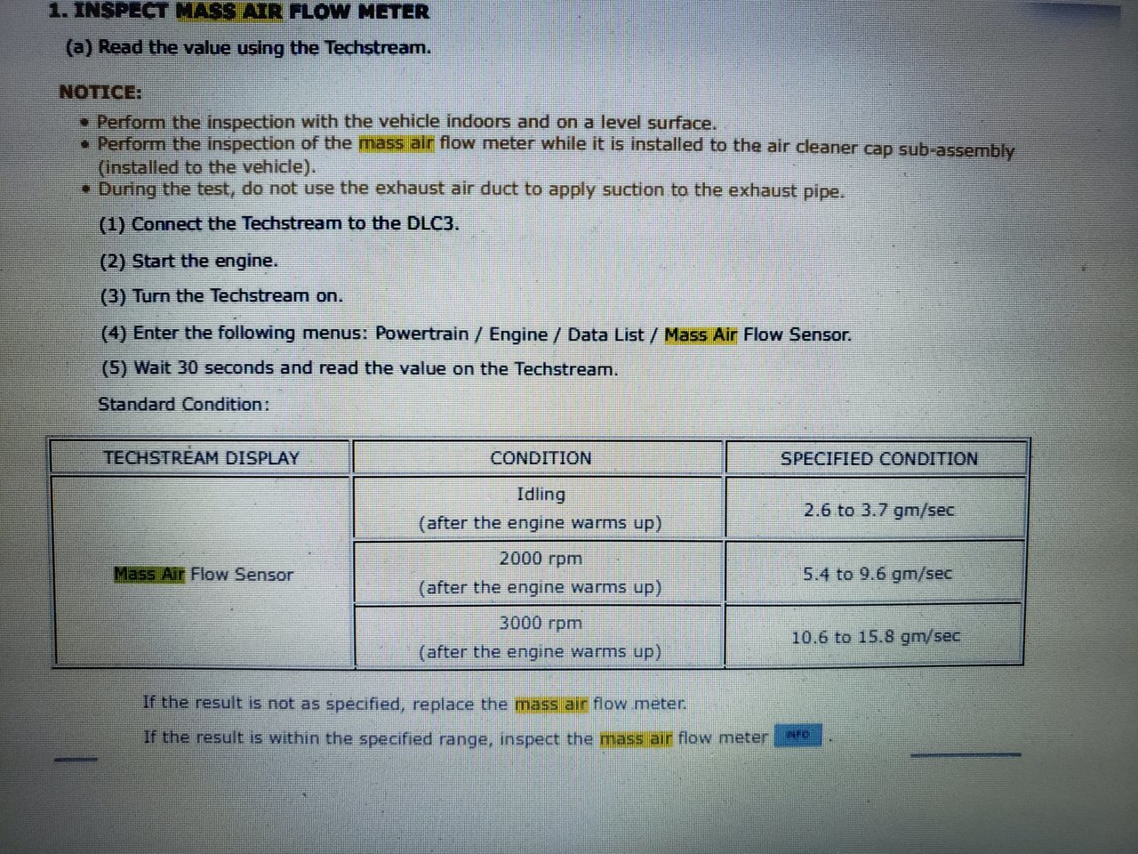

  2. Sep 17, 2023 at 5:19 PM
    #62
    Vlady
    Vlady Well-Known Member
    Dec 20, 2017
    #238986
    4,626
    Issy, WA
    2017 White SR5 DCSB V6 4x4
    The testing is in Parked.
    50 at 3K rpms is normal. Pay attention to Engine load.
    Must turn lights and air to test in idle

    Lights and air off right?

    Yes, lights, air, ac are off. Engine is warmed up. Don't touch the steering wheel.
    You can use any obd2 application, just factor in a slow refresh rate.

    2018 TRD Sport Crew Cab 4x4
    So I did the maf test, and actually I’m thinking it might be in a fairly normal range after all! I guess it pays to know how to test things properly! I’ll upload a vid, and I have a few more with some sounds and the spark advance numbers. This drive was really rough, still terrible mileage, and the engine felt like it was going through cyclical bursts of shaking about 2 seconds of shaking, and 2 seconds of running normally.

    I’m having trouble uploading my videos but here’s an iCloud link, I hope that works. This is the MAF test, and I’m pretty sure this is a normal result.
