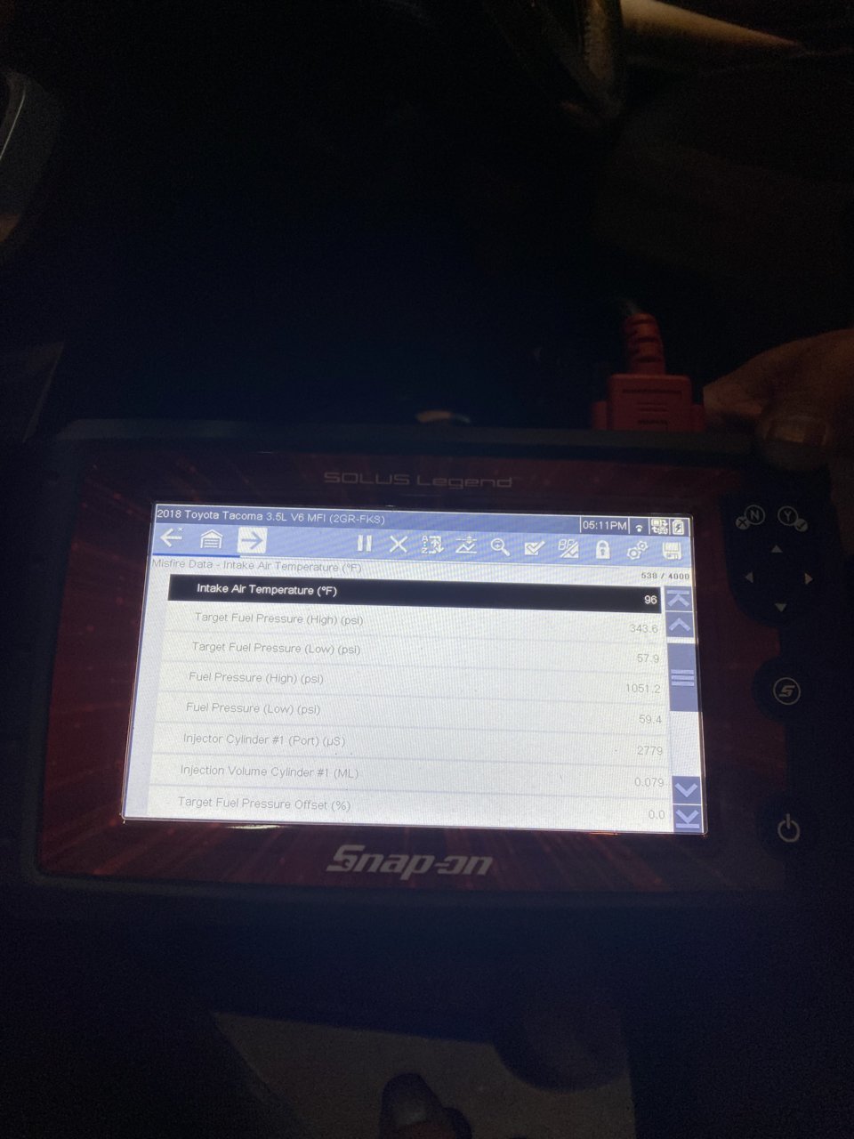

  8. Sep 17, 2023 at 10:04 PM
    #88
    Nikvic
    Nikvic [OP] Well-Known Member
    Aug 5, 2023
    #430553
    74
    Nikko
    Vancouver, B.C.
    2018 TRD Sport Crew Cab 4x4
    I think I made a mistake there, on my mechanic's scan tool it showed a target low fuel pressure of about 50, so I think that's where I got that number from. The high target pressure says it should be 343.6 and the actual pressure was 1051.2
    Totally willing to accept that I don't know what I'm talking about here. I can't find any information on this online anywhere
  9. Sep 17, 2023 at 10:05 PM
    #89
    Nikvic
    Aug 5, 2023
    #430553
    74
    Nikko
    Vancouver, B.C.
    This is what I was basing that off

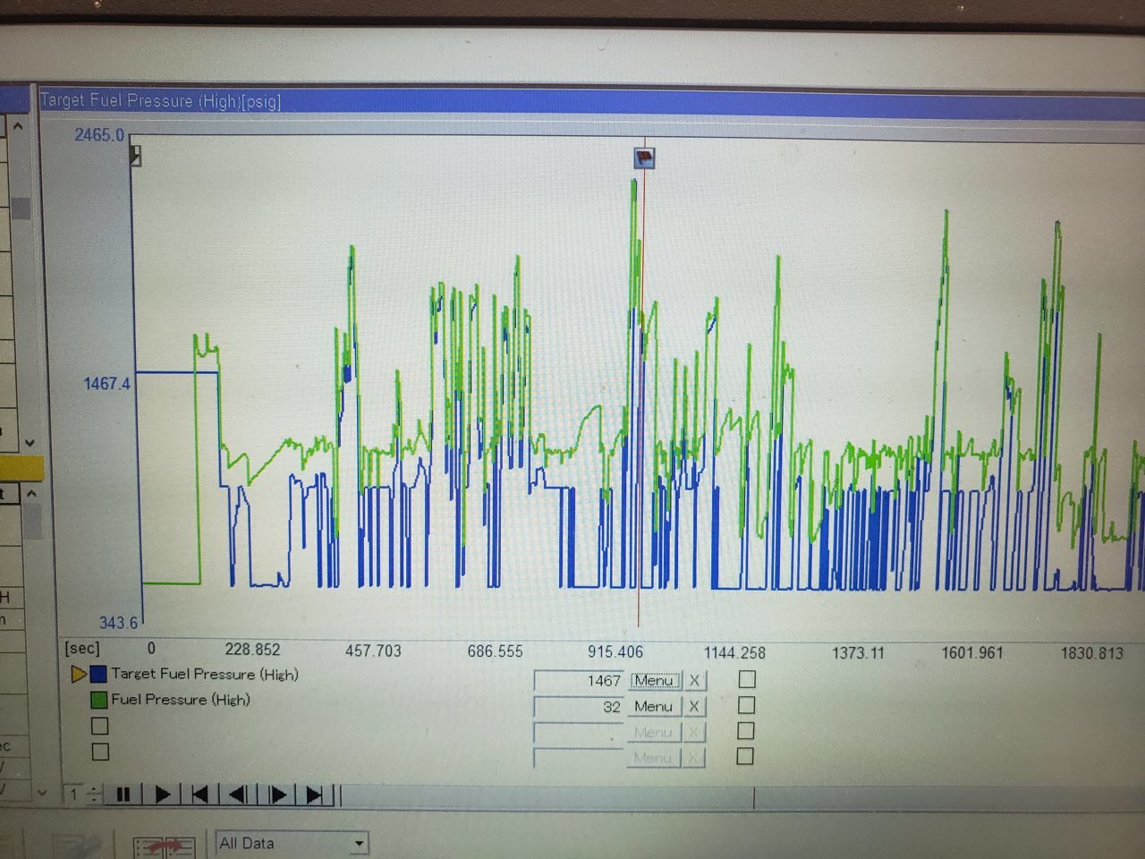

  18. Sep 18, 2023 at 11:25 AM
    #98
    Vlady
    Vlady Well-Known Member
    Dec 20, 2017
    #238986
    4,626
    Issy, WA
    2017 White SR5 DCSB V6 4x4
    That's totally normal state. Targeted pressure does not match actual.
    Here is the data from "healthy" engine
    TnShooter and Nikvic[QUOTED][OP] like this.
