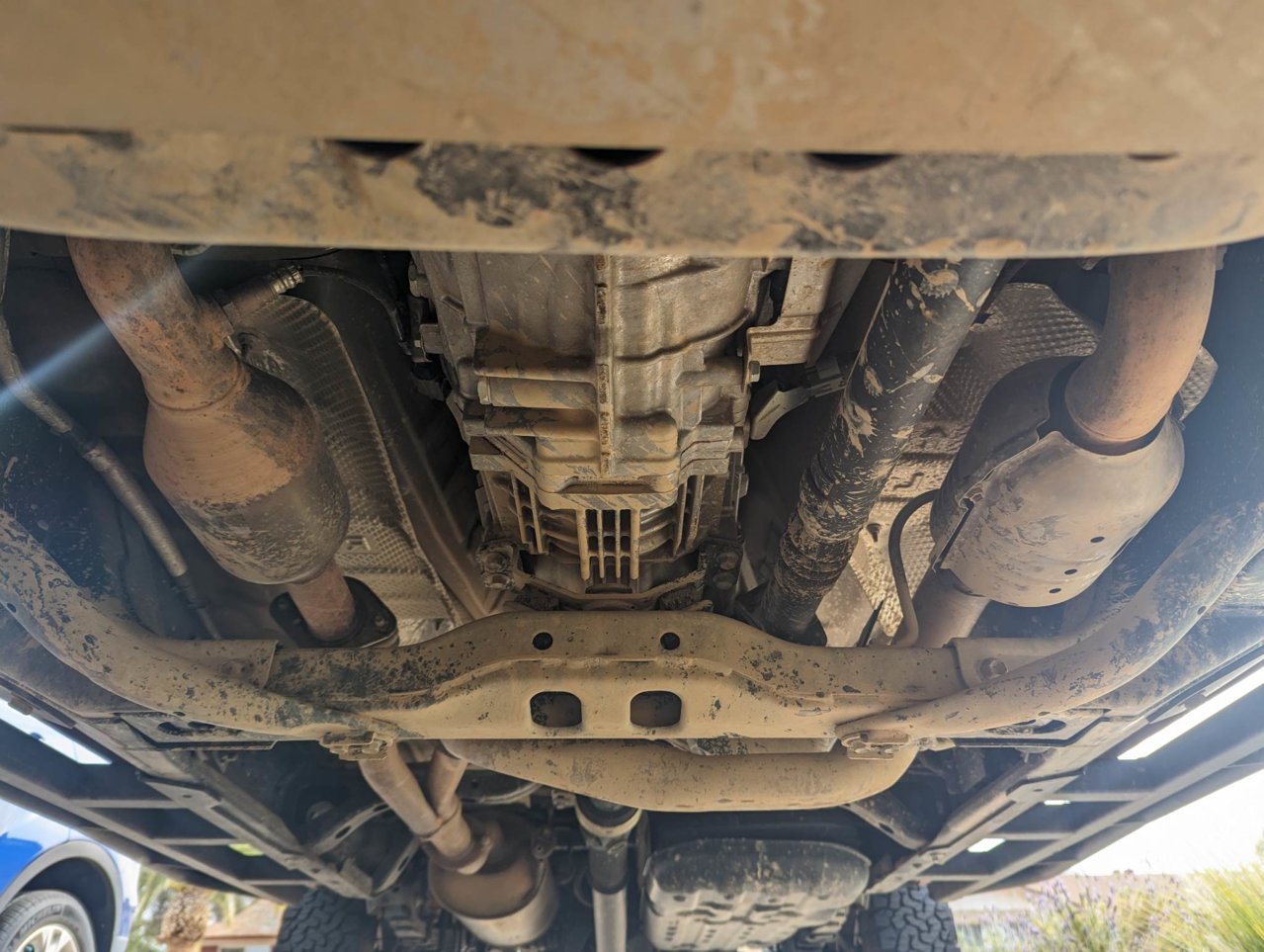

    Ok, actually I’ll try and update quickly now! Basically I borrowed the o2 sensor socket from my mechanic and thought I would try to get the pre cat o2 sensors out to check the cats. I stopped after trying by using a long socket extension and it just felt like I might bust the sensors or something else because they were so rusted in. My mechanic also told me not to continue when I came to return it, but he then spent an hour with me over a couple of beers and helped me with a mechanics stethoscope. So now maybe I should relay what his opinion of the symptoms and their relevance and severity are.
    so he thought that the timing chain didn’t sound bad, but there’s still definitely a ringing that seems to be getting worse, and may be valves.
    He said that the engine really sounded terrible around cylinders 3 and 5, but the rest of them sounded great.
    Touching the stethoscope to those threaded holes near the pcv I noticed a terrible racket too but forgot to mention it to him.
    when I set the ignition to on but the engine was off, I pushed the gas pedal and tried to test the throttle position sensor like an article told me to and it wouldn’t move at all, but definitely does when on or I’m driving. Is this normal or does it not move or read with ignition on with these push button ignitions?
    all wiring looked good, fuses good, but I never did anything with any of the relays, I still need to look that up.
    so basically the knocking seems to be coming from the passenger side of the engine, more specifically 3 and 5. The fuel and vacuum pumps make some noise but it’s not crazy. One of the cats is missing it’s heat shield, is that normal?
    The maf is over 500 bucks at lordco even with my “bc ferries” account discount… feel free to dm me for the account number if you’d like, I think it’s a 30% discount so I’ll try and get it this week, but more and more the numbers seem to look closer to correct.
    Ignition timing is still super retarded at times but just for a second then back to every range of advanced and all within 5 seconds.
    so basically I haven’t done much and he just gave it a solid listen and I’m dropping it off to him Monday after work and he’s going to actually give it a go.
    he has a friend who knows the owner of the dealership I went to, and after grilling me to make sure I didn’t get out of line, raise my voice, or really truly deserve to get booted, he’s going to make the call and try to get me another chance to get the warranty work done there and have them take it seriously.
    so some progress, but besides a token effort due to time, funding and ability, I haven’t been able to do enough to feel worthy of all of the time and effort you all have given me, but I will and it’s the foremost thing on my mind!! Thank you, and please don’t give up on me!!!
    I'm calling this one totally normal... my drivers side cat has shield, passenger doesn't, my friends truck looks the same...received_519848880060664.jpg

    #326226
    8,063
    Michigan
    2017 Black TRD Off Road 4x4, 2019 MGM 4Runner SR5
    Yes this is normal

    No need to apologize. I actually ran into this exact same question recently when searching for a noise I had. Upon looking at the part diagram, I noticed there wasn't one for both sides.

    I’m surprised to see that OPs TRD SPORT has gas tank OEM cover/skid plate.
