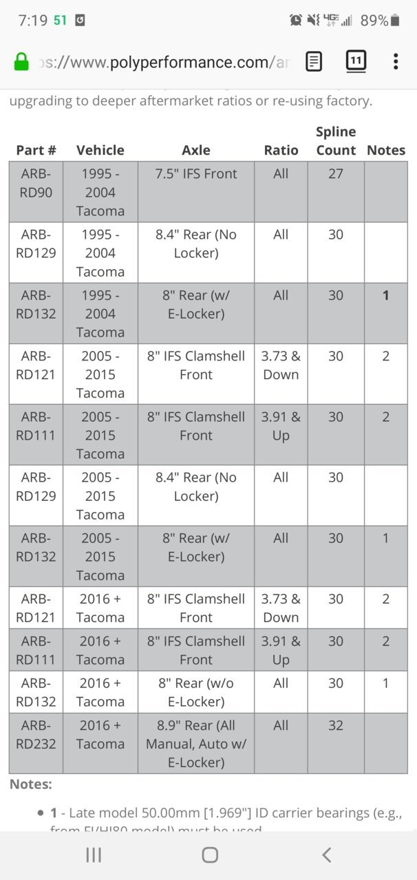

    From what I read all the TRD models have 8.75" rear end.
    @shakerhood or @tonered know

    Nope. See the applications guide I posted.
    OE e-locker trucks (Pros and OR's) have the 8.75 along with trucks that came with the manual transmission. An auto Sport does not have the 8.75.

    Thx, just trying to find the ARB locker for OP, looks like it's RD132 (and didnt see the post above)

    Manual Transmission Sport gets the 8.75" as did the 2016-2017 SR Manual, outside of that only the OR and Pro have it.

    So what size does a 2018 automatic sport have?

    8"

    Does it matter if it's 4 or 2wd?

    Nope
