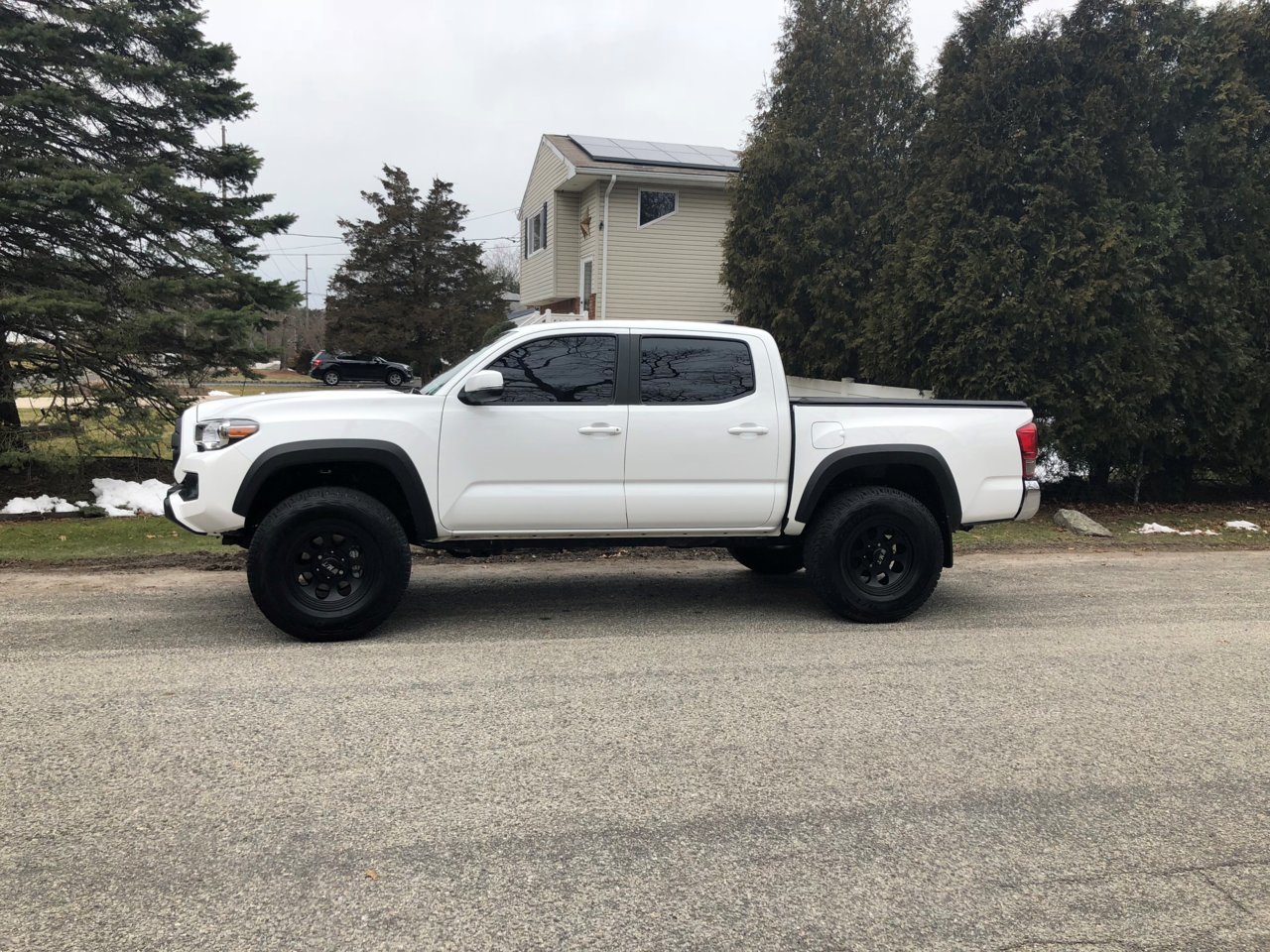

    this is with a 1" spacer up front giving 2" of lift AND a 1" block in rear giving 1" of lift, front was way to high

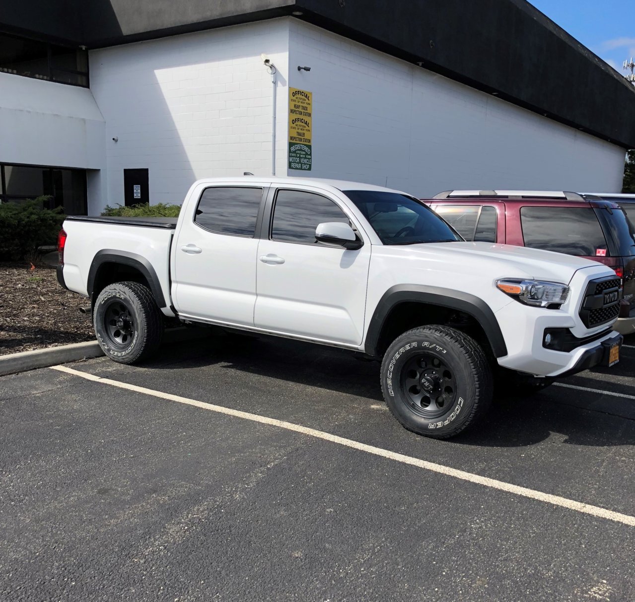

    and here it is with the 1/4 spacer lift in the front and 1" block in rear
    with out the rear block the front would be level

    Is that a ghost in the window under the sales department sign?

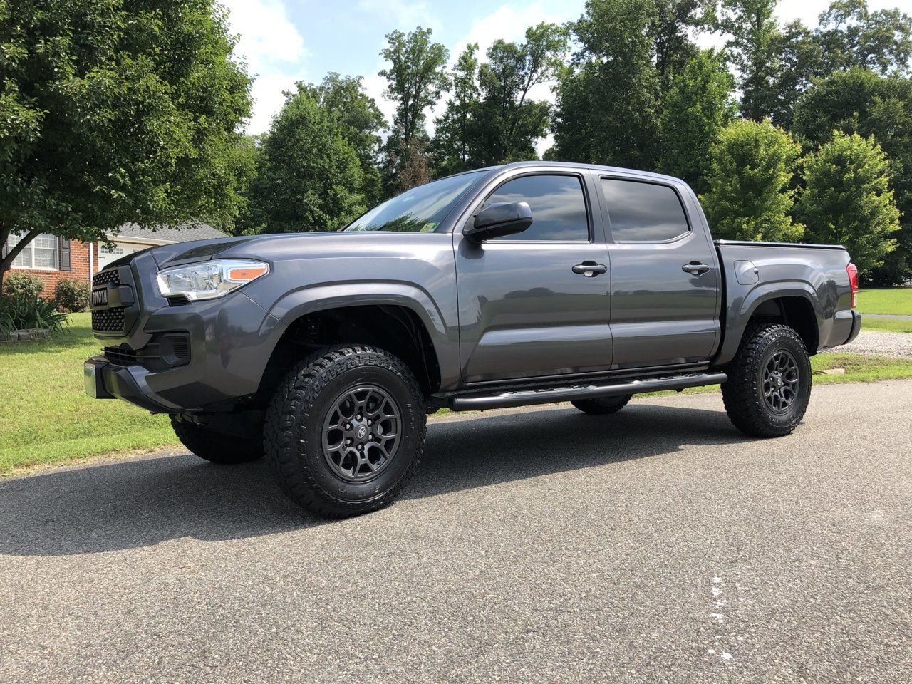

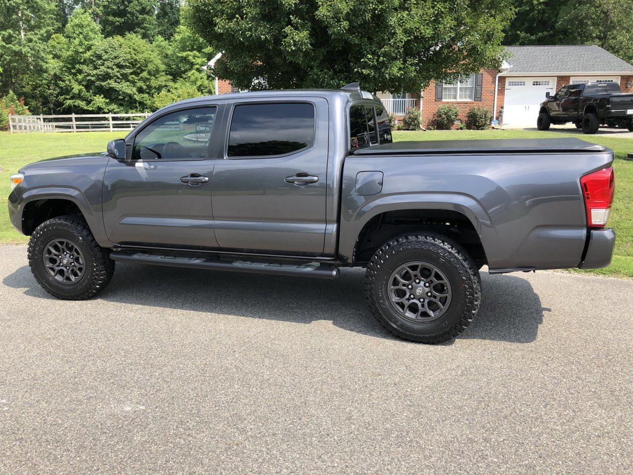

    D335112F-FE25-4738-A35A-936055A24915.jpg 12F6B742-A0A4-44CC-A0F0-7FC72C204978.jpg 2.25” in front and 1” in rear dead level

    Are those the 5" OEM tube steps?

    Yes they are
