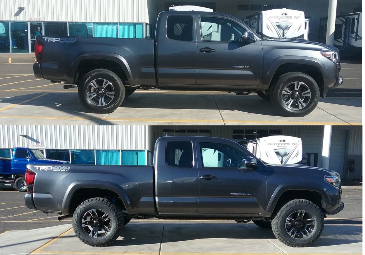

    Good point, here are the before and after pictures:

  6. Feb 8, 2019 at 7:22 PM
    #46
    Roddy13
    Roddy13 Well-Known Member
    Sep 9, 2018
    #265775
    484
    Thanks!
    Did you conclude that you should have gone 1.5” or do you think it’s level in person?

    The concrete slab the truck is on in the pictures is a dedicated level slab for hooking up 5th wheels at a dealer. I put a level on the bed rails before/after and it's perfectly level now. I definitely think 1.5" or more would be to much unless you also added lift in the rear.

    Do you have an after pic with the stock wheels?

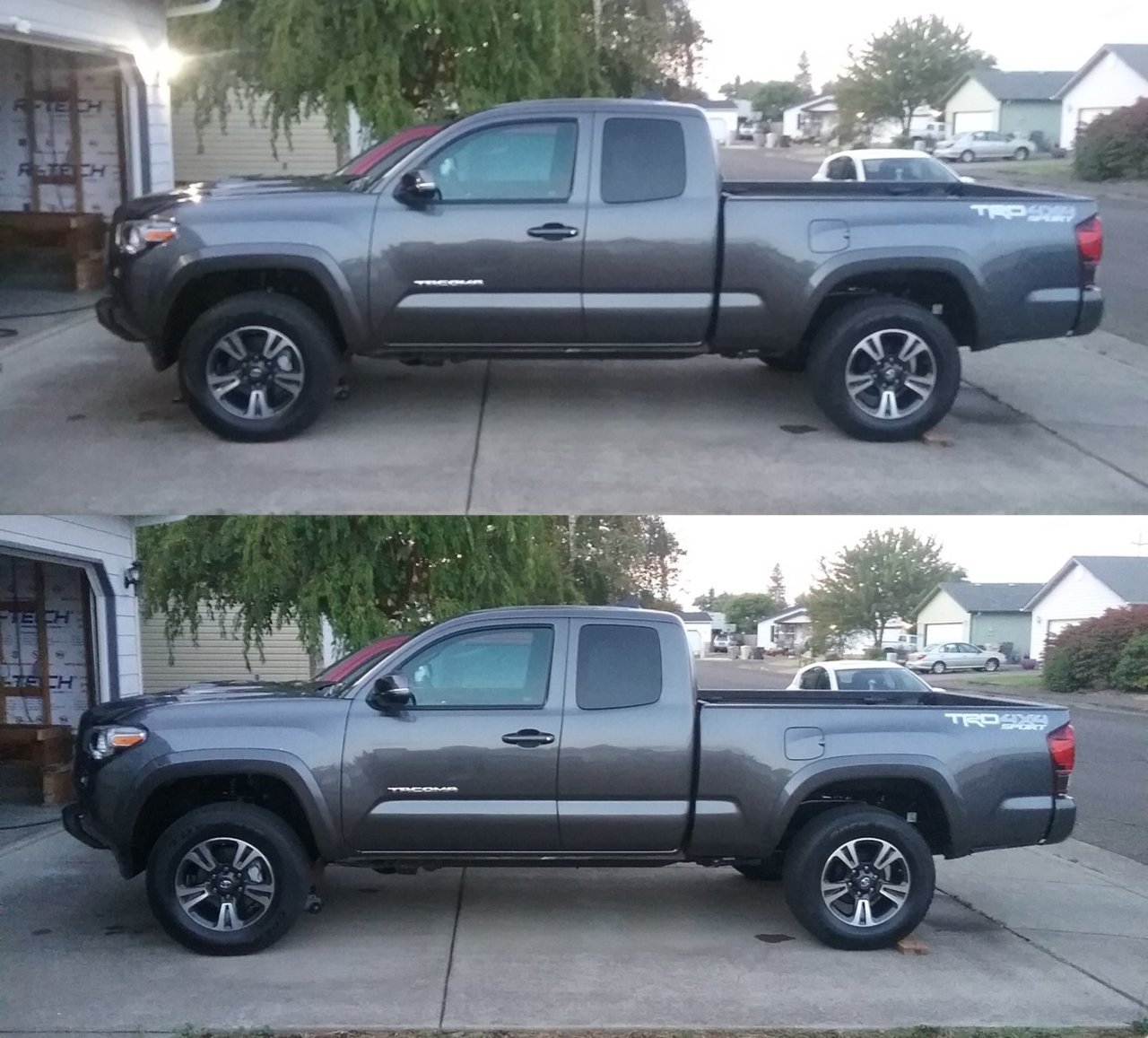

    I don't as I had the suspension and wheels done at the same time. However, while I was researching, I jacked the front up one inch to see how it would look. It seemed to me that a full inch was a little to much but here are the before and after pictures:

    190
