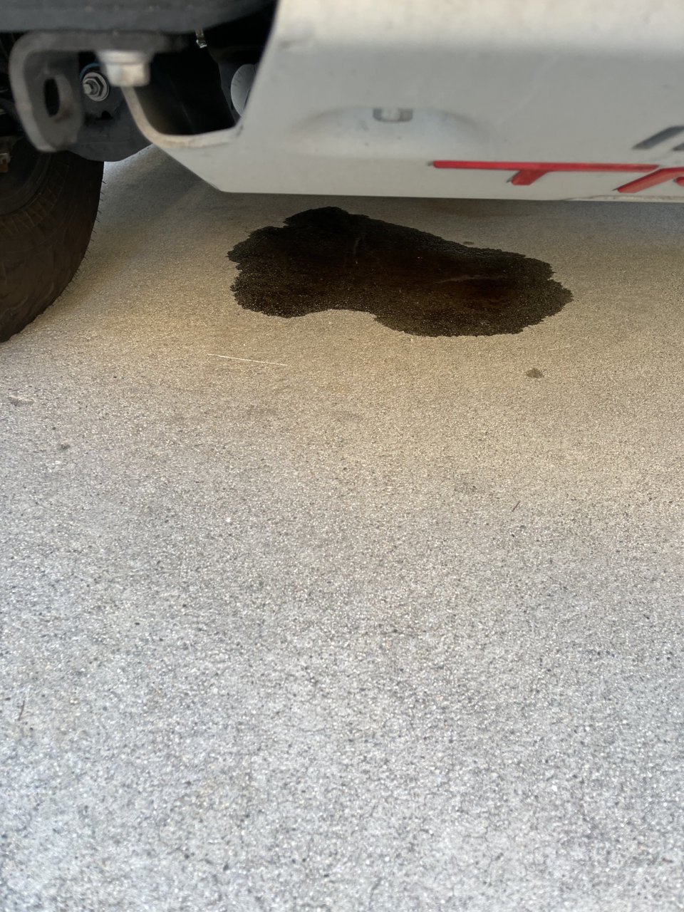

    Update: somehow, they got their hands on the replacement parts and performed the recall yesterday. When I got home I noticed a major oil leak. Back at the dealership now...

    Probably just sloppy work. They probably just didn't clean up the old oil that got on the skid plate. Like pulling the filter housing off and not draining it prior. Letting the oil filter pickup /inlet dribble on the skid plate etc. Hope that's all it is. Good luck.

    Thanks. They accidentally put two washers on the drain plug. Sloppy work indeed. Took one off so now should be all good.
