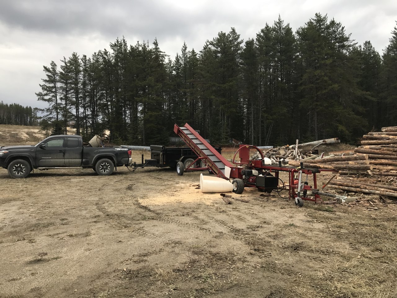

    I tow a 6x10 dump trailer full of firewood weekly, many times a week with my ‘17 OR access cab MT.
    That firewood trailer is 4-6000# depending.
    Air bags would be nice.
    As far as the tranny/engine, the only thing I notice is having to rev it high. I doubt I’m below 4000 on normal shifts till I’m up to speed. There is no torque below 2000.
    I’ve done the 2Lo mod. It’s awesome. About to delete the clutch accumulator.

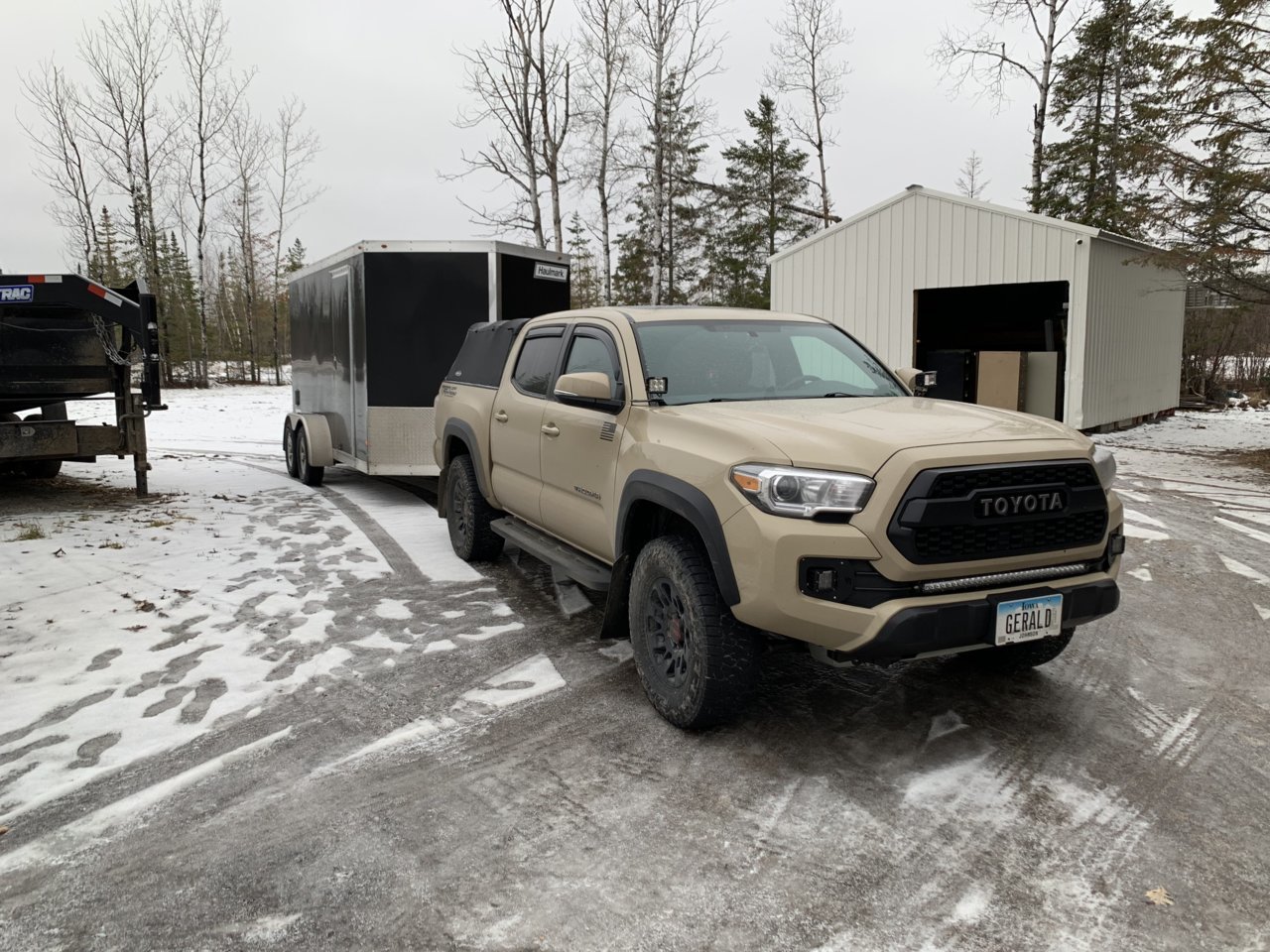

    A better shock helps too. Swapping my rears put an end to the oscillation you’ll get on the highway.
    A lot of it depends on how much weight you are gonna have. I’ve done up to 3500 lbs ish having just replaced the rear shocks and run it all over the country with no complaints.
    If you are going to be running WDH, I’d start with the shocks and see how it tows. Just the rears was like $250 and an hour of work moving slow.

    I’ve got a 7x14 trailer I haul around. Going down the interstate there’s spots where you’ll get a lot of oscillation with the factory suspension. I’ve been running Fox 2.0 in the rear and it makes a huge difference with my setup.
