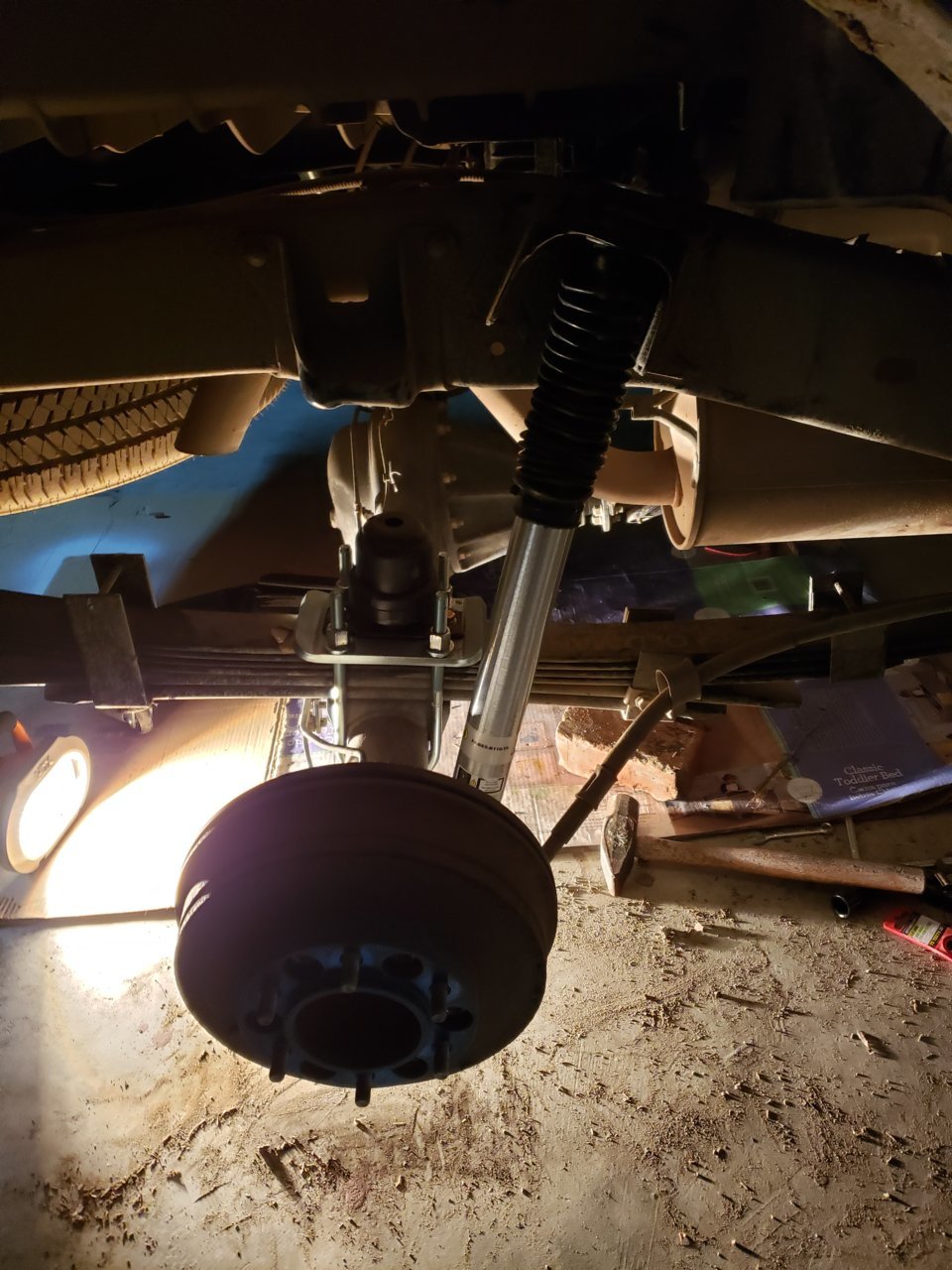

    It might be camera angle, but those u-bolts look extra long on the top side. Might want to check make sure they aren't hitting anything else before bumpstop does its job.

    I thought so too. I think I'm going to take an inch off them? It's what wheeler's offroad sent me. I even got a 3/8" spacer on the bump to accommodate for my extended shocks uptravel. So the u bolts are really long.

    I had to chop mine off about an inch or so. I just used angle grinder.
