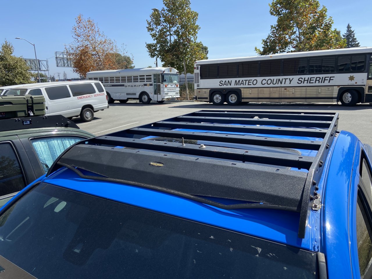

    That thing is falling apart at the front. I'm looking to buy a Roof Rack but need to find out which ones to avoid. Obviously, this one is in that category.
    Also, the mounting points looks like sealant had to be used...assuming it was used.
    Ed
    EDIT: That's a nice truck though...

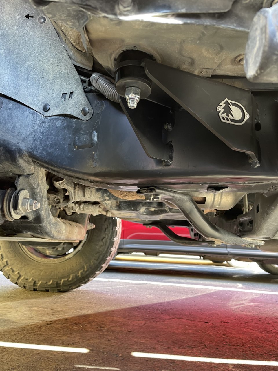

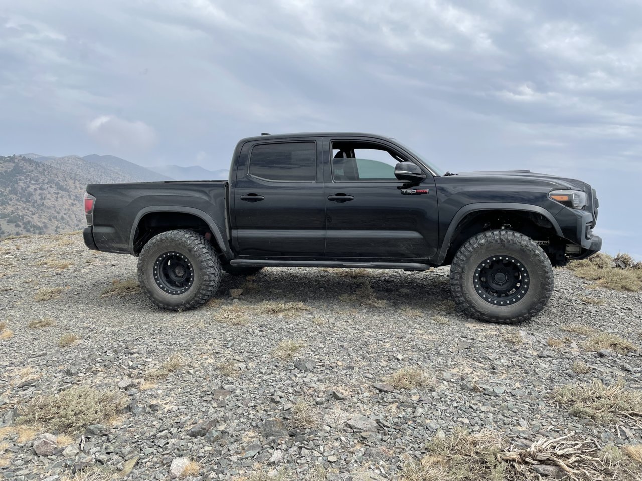

    I'm running 35x12.5x17, but as you see in the pictures I also had to trim my fenders (2.5" trimmed) plus I did a cab mount relocation from Alpine Designs right before I made the jump to 35's, a simple CMC is not enough unless its a very aggressive chop, this is why a lot of guys stick to 33's because it takes a lot more effort to making 35's fit right, I still slightly rub the firewall at full lock when the tire is stuffed which is why I am getting it tubbed out soon. As others have mentioned there is also other things that need to be considered or should be such as gearing.

    For 285's or 33's (they are nearly identical in size btw) a CMR (cab mount relocation) is unnecessary but you will need a CMC (cab mount chop), some guys do not even need a CMR with 315's or 35's depending on the rim offset but a more aggressive CMC is still usually in the realm. With 285's or 33's you also do not have to worry about rubbing the firewall, at least I have not heard of it, those are 35" tire problems.
    For regear go 5.29. There are guys on here running 5.29's with no lift or oversize tires and love it. Some of the guys who went 4.88 regret not going 5.29 but then there are those who say 4.88 is perfect for 285's/33's, to each their own but I like the "buy once cry once" philosophy. Also if you ever tow or haul anything or are constantly driving up steep grades you will really appreciate the 5.29's. If you live where there are no mountains and it's all flat land you may be just dandy with 4.88's, you'll get slightly better fuel mileage.
    As mentioned ECGS is a acronym for a company called East Coast Gear Supply, they manufacture a smooth sleeve bearing to replace the factory needle bearing in the front diff. Personally this I have not done, I also like the "If it ain't broke don't fix it" philosophy as well but some people prefer to be more preventive, I am more of a reactive kind of guy o_O. My truck has nearly 70K miles of lots of highway and offroad and no issues with the factory needle bearing. *Knock on wood*. It is hit or miss for some.
