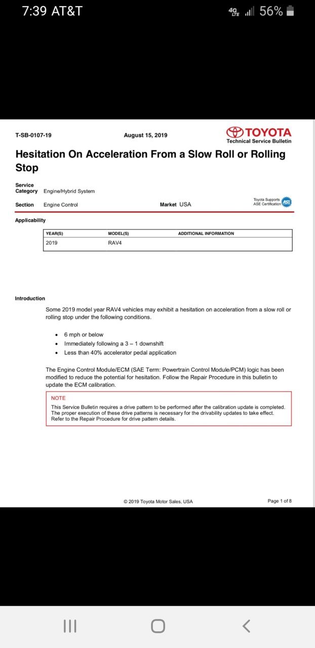

    Take it to the dealer and tell them the ecm needs reprogramming to fix the lurching problem. They'll know what it is.

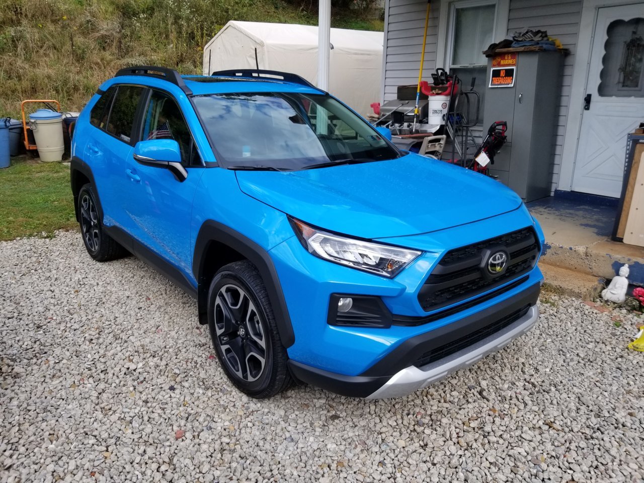

    Saw one of these things for the first time on the street today. The marketing material makes it look much nicer than in person.
