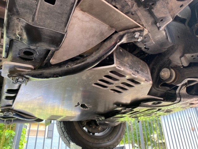

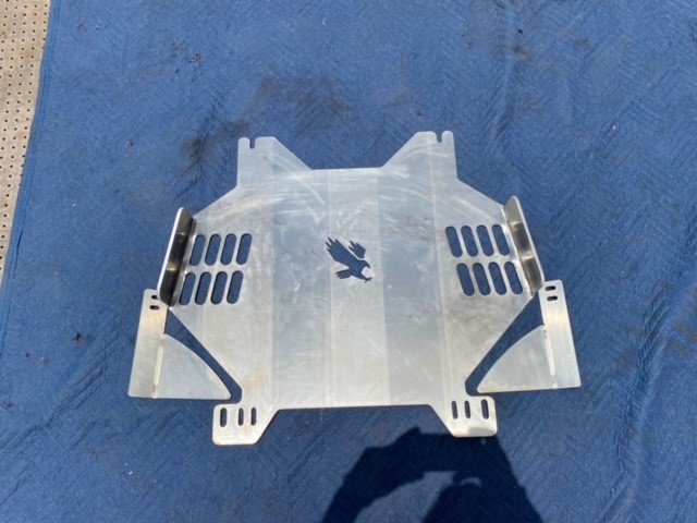

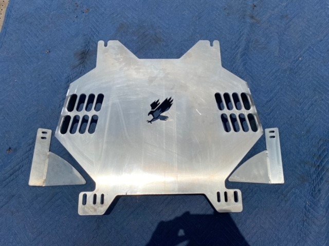

    Came across this thread researching some other cat thefts.
    I recently designed and made a skid plate for the 5th gen 4 runner that would both act as a off road skid plate, and help protect the cats. It is made from 1/4" Aluminum. I have looked under a few Tacomas and I beleive the mounts I use are the same on the Tacoma. Anyone around Houston want to bring a truck by for a test fit?
    Maybe I should cross post this to the other threads.

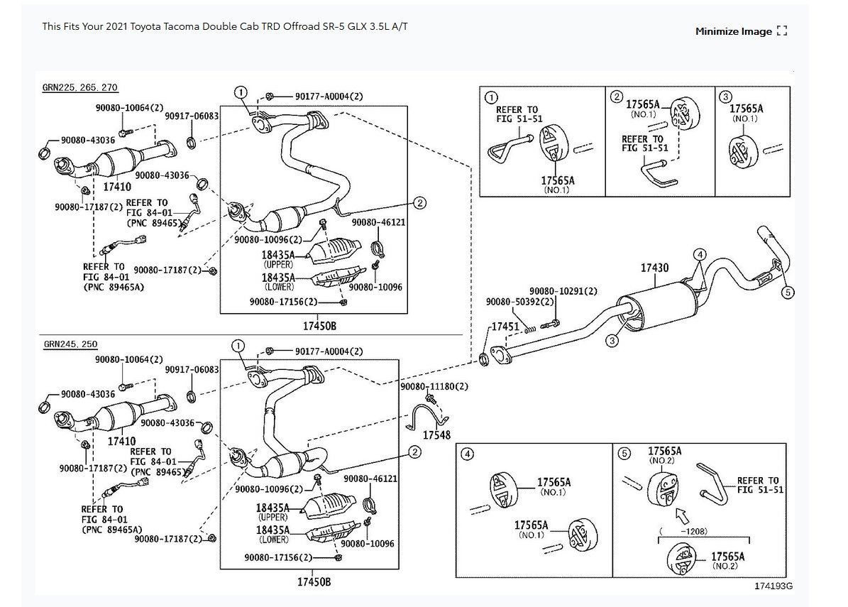

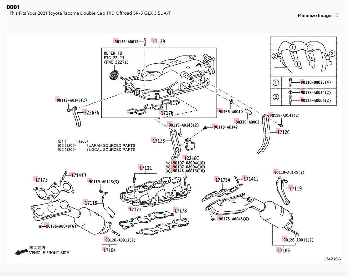

    What year Tacoma do you have? 4 cylinder or V6.
    Challenge is our trucks are lifted. Toyota used four cats on the V6.
    You can put full skid plates under the vehicle. Add some "wings" to the skid plate to limit access to those lower cats.
    Idea of shield is to slow down a thief, so they go elsewhere. Engrave last last six digits of your VIN and spray paint with high visibility paint. Helps the cops bust theft rings, most thieves skip ones painted for that reason (it stinks for a couple of days).
    2021 V6; note cats are built into the exhaust manifold
    Exhaust Pipe
