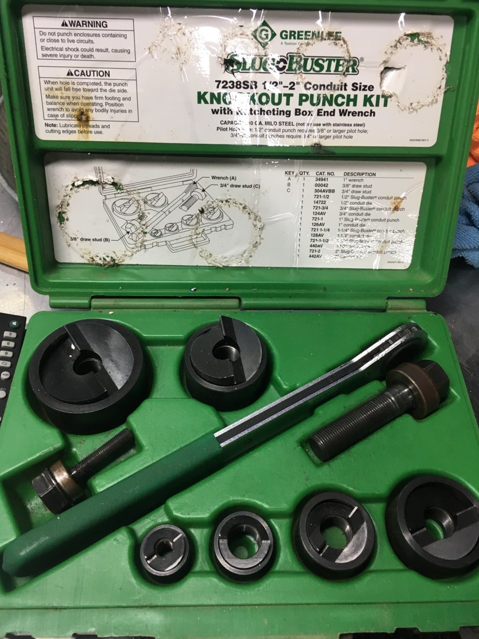

  11. Jan 7, 2019 at 3:32 PM
    #31
    dolbytone
    dolbytone Well-Known Member
    May 14, 2010
    #37165
    1,328
    South Carolina
    09 TRD Off Road
    Lat time I put tweets in a sail I was able to use this. It just depends on the size of the tweet maybe but I’ve done it twice with different brands. Nice clean hole unless your plastic is hard AF, then it might crack possibly.
