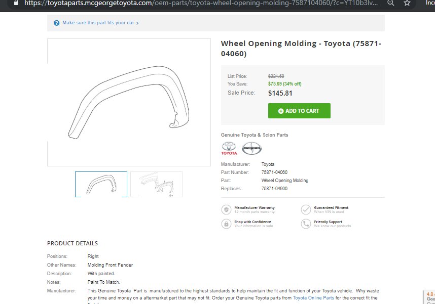

    They come painted from Toyota based on what it says online.

    They don’t. They come stock black. The finish is really thin and flat on the sports fender flares.

    Are you sure the body shop ordered the correct flare for you truck? The off-road and pro flare has a different texture than the sport. If they ordered the off-road/pro flare the different texture may have cause the final paint job to look different. If you can, check the back side of the flare and the part number will be on it.
