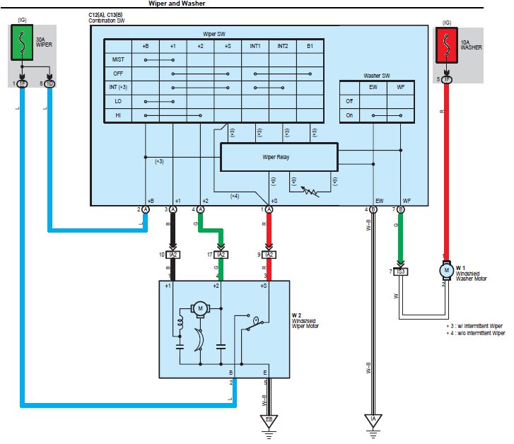

    Just to be clear this intermittent wiper switch works on sr5 2019 correct. Also does the washer fluid work with the new intermittent arm switch?

    The different in function is the intermittence. Both types of switches have the washer feature.
