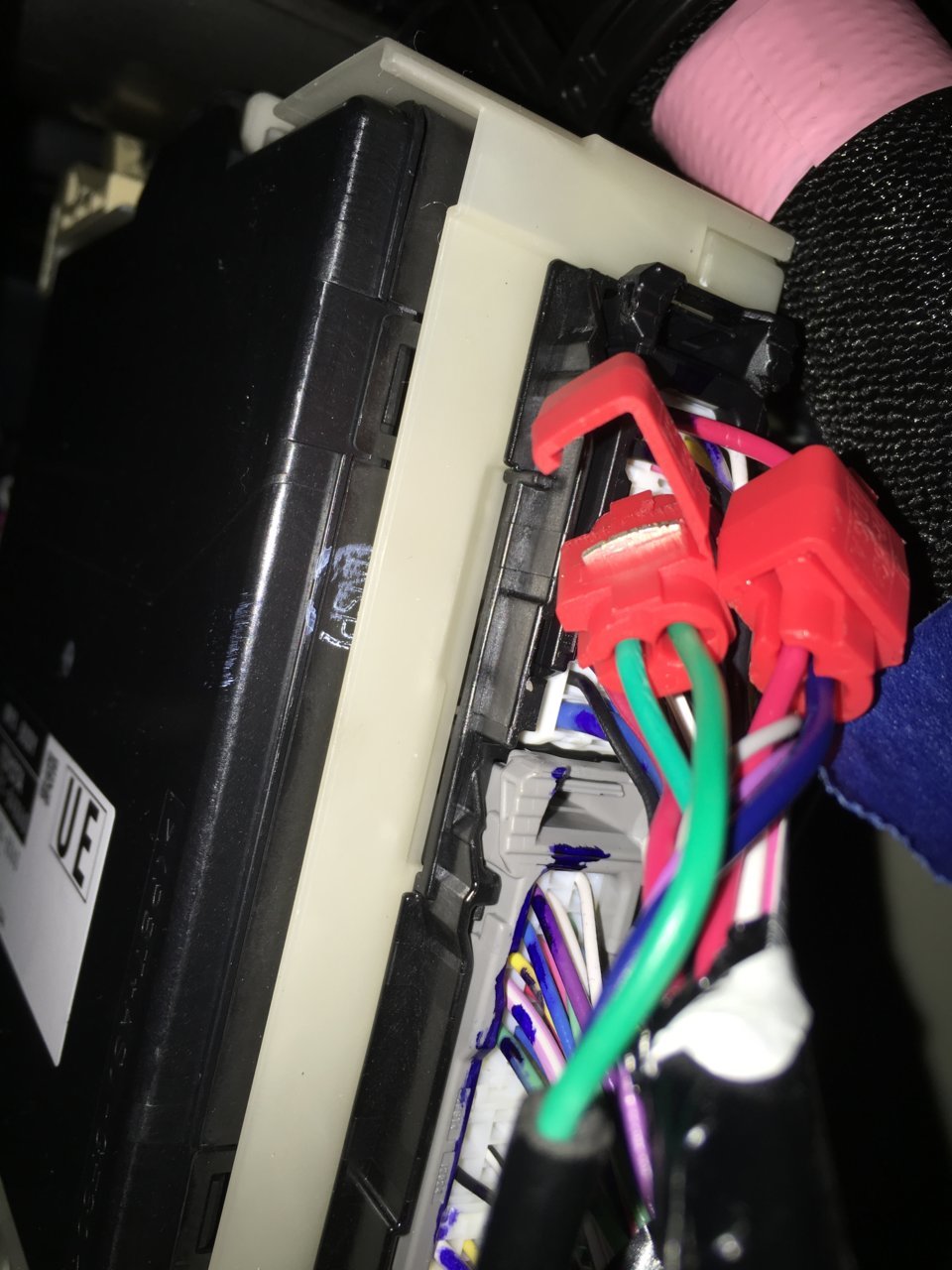

    I have invested in good crimpers for all gauge wires, and I will tell you that some of them are stronger than the wire or any solder.
    I do use heat shrink to make everything look pro.

    Good crimpers are great but corrosion is a killer IMO.

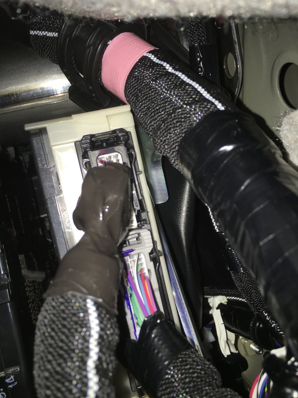

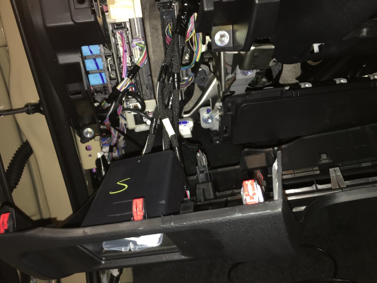

    I finished my installation of the tailgate lock. FYI most video's on-line show the two wires from the lock going to the passenger side (easy). I believe going this route only allows the lock to work with the key fob. I followed the Southeast Toyota Accessory Installation instructions and used the connector on the drivers side (hard). This allowed me to use both the key fob and the door handle to lock and unlock. Now I don't need to remove my fob from my pocket. Easy so to speak.
