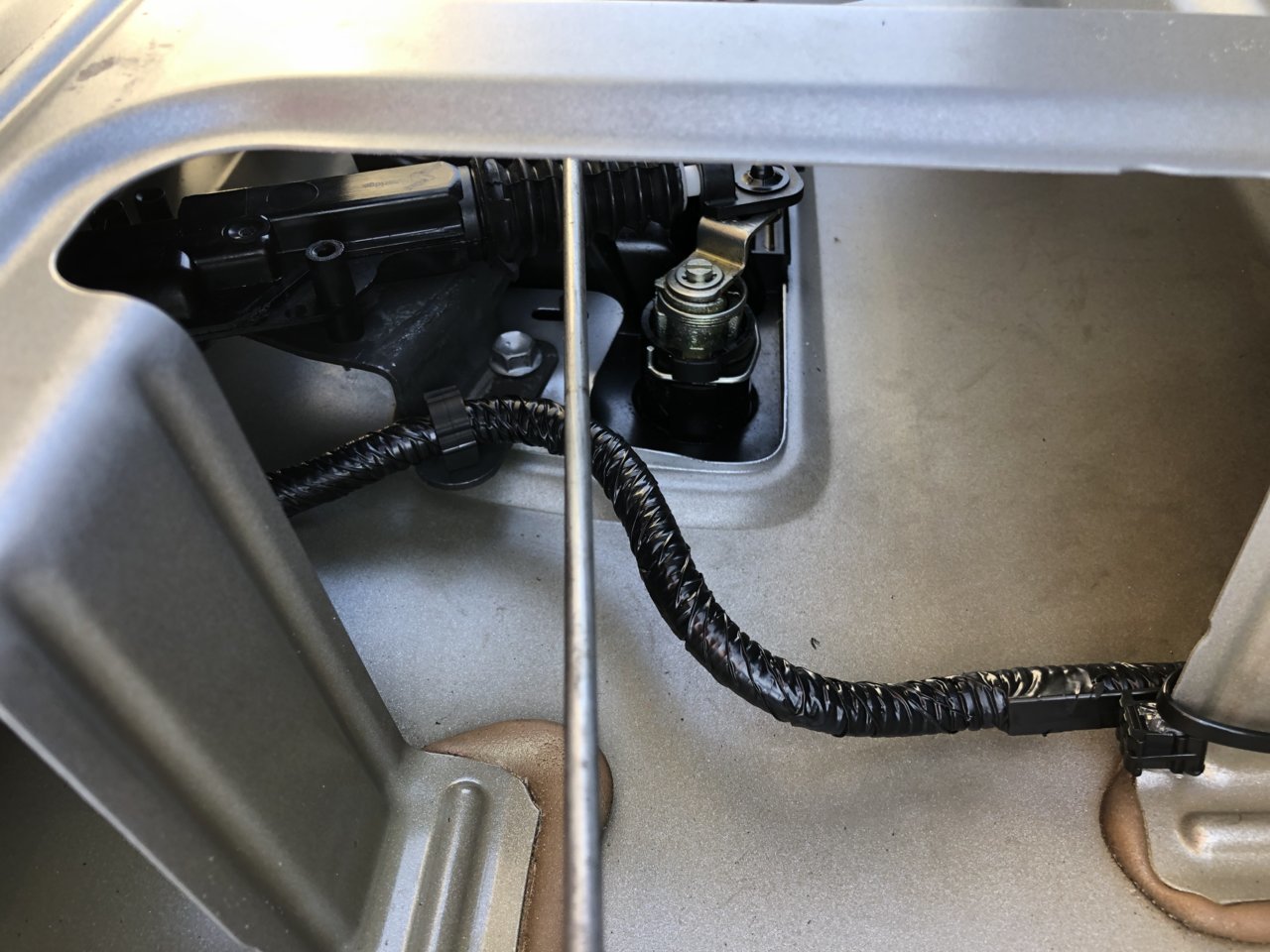

  12. Jan 4, 2020 at 4:34 PM
    #192
    plim
    plim Well-Known Member
    Aug 9, 2019
    #301681
    84
    Pascal
    2019 Black TRD Pro
