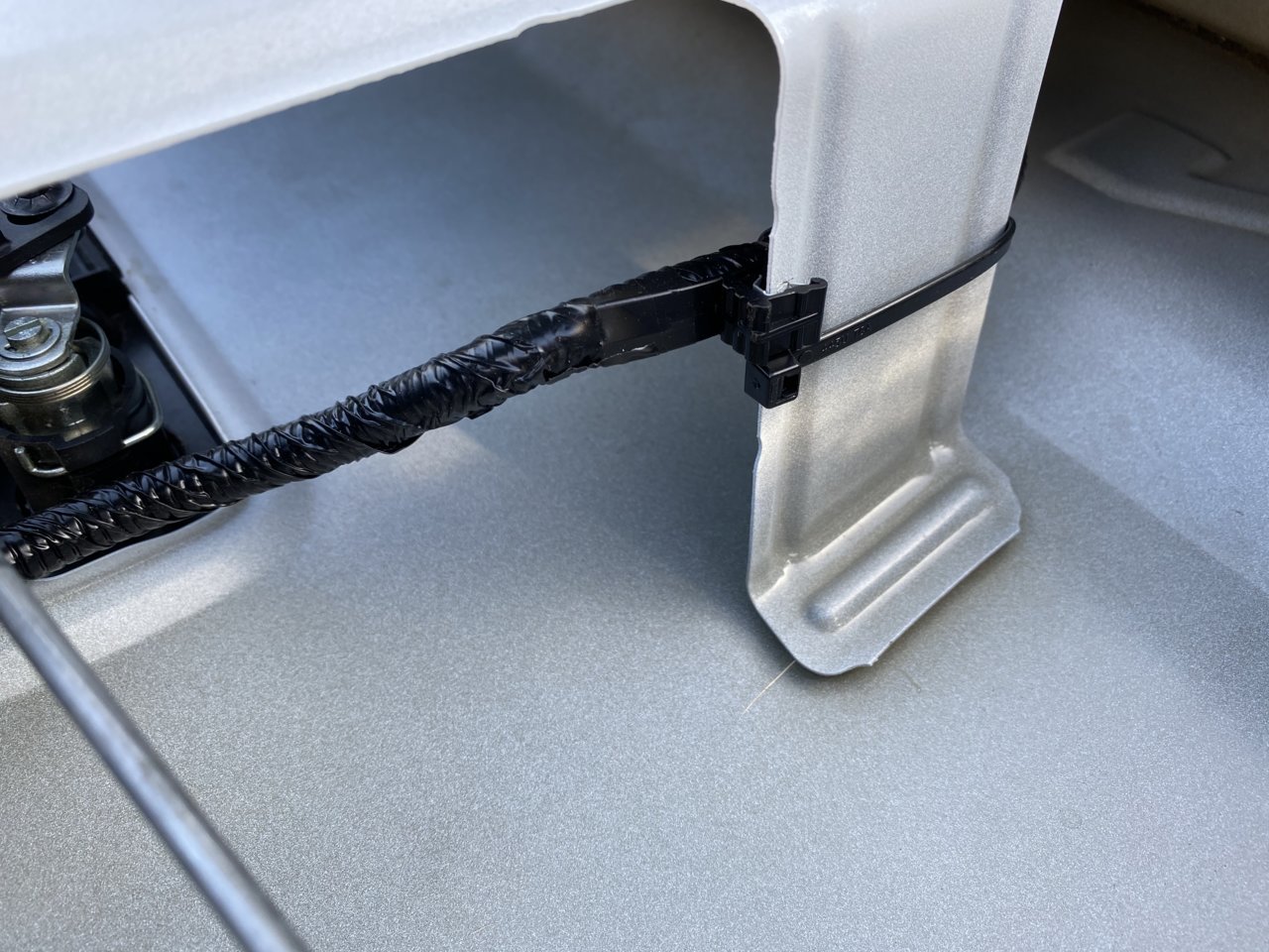

    What is everyone doing instead of the 3m seam sealant that’s applied to the wire harness clip? That 5oz is 26$

    I used JB Weld RTV since it was what I had.

    If you dont wa t it to rust.

    any rtv, silicone sealant will work fine. Ski

    What I did is put three strips of electrical tape on the metal part of the tailgate before I put on that clip. I hope the clips teeth didn’t went thru it...

    Probably not considering it will be a small scratch in the metal. Can it rust, sure but will it rust out or do any harm flopping around, probably not.
    it’s more for me to appease ocd. It’s written for a reason/precaution so I’ve already seent it :rofl:but I also torque my lugs, oil & filter plugs or anything that has a specified spec :anonymous: truth is it probably won’t get any better being that this is my 1st new vehicle (at 35). And unlike my younger self I have learned things last longer if you take care of them so this truck gets the white gloves
