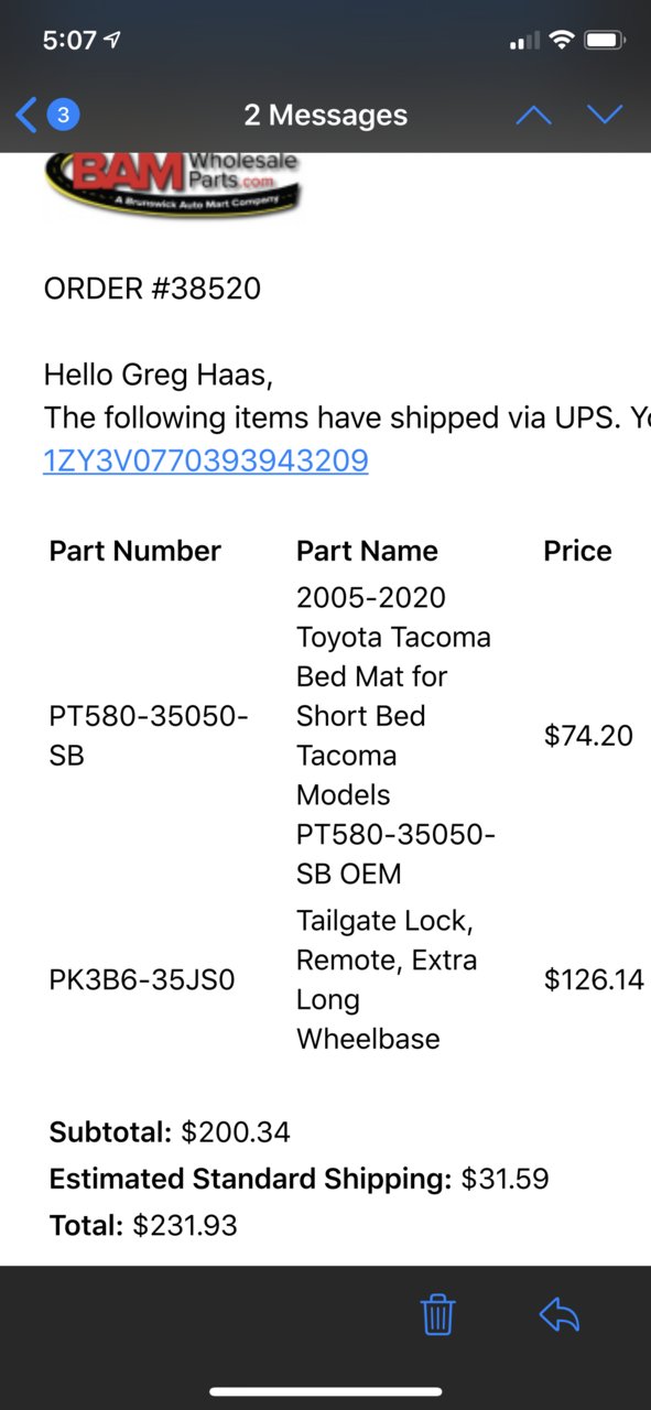

    Cmon! BAM Wholesale part sent me wrong part that’s for the long bed! I have a short bed!

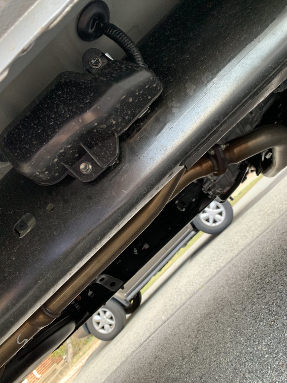

    Also, what is this??

    Not related to the tailgate kit. Look farther inboard and there is another unused port for entry into the cab.

    The plastic cover is just a gravel guard for a couple of large electrical connectors.
