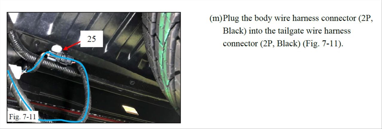

    Does this kit include a disconnect between the tailgate and the body?
    Asking cause in the event that I have to Remove my tailgate or prevent my dealer from accessing the bed, I like having the ability of a quick disconnect.

    The minimal method would be to unplug at the T harness in the passenger footwell area. That might be a pain though. As an alternative you could splice and install a switch and hide it.

    Yes it has a disconnect plug, similar to the camera. I haven't actually installed mine yet (hoping to get it done today) but I think you could simply disconnect the plug, then carefully close the tailgate and lock it using the key when you take it to your dealer.

    Is the disconnect located outside the tailgate?
    Or inside the tailgate, the same at the camera?
    My current PopLock has the disconnect outside the tailgate, in between the tailgate and the body.

    I've never attempted to remove my tailgate, but the owners manual talks about a disconnect for the camera just under the bed at the rear. Again, I haven't installed the tailgate lock yet, but page 19 of the install instructions seem to indicate a disconnect in that same location.

    It wouldn't be difficult to add a quick disconnect, outside the tailgate, if desired.

    There are disconnects for the camera and power lock. As a matter of fact in your glovebox should be a plastic bag with protective covers for the camera plugs. The plug is just inside the roll pan underneath. I zip tied the lock plug right next to the camera plug. No problem to remove the tailgate. And done.
