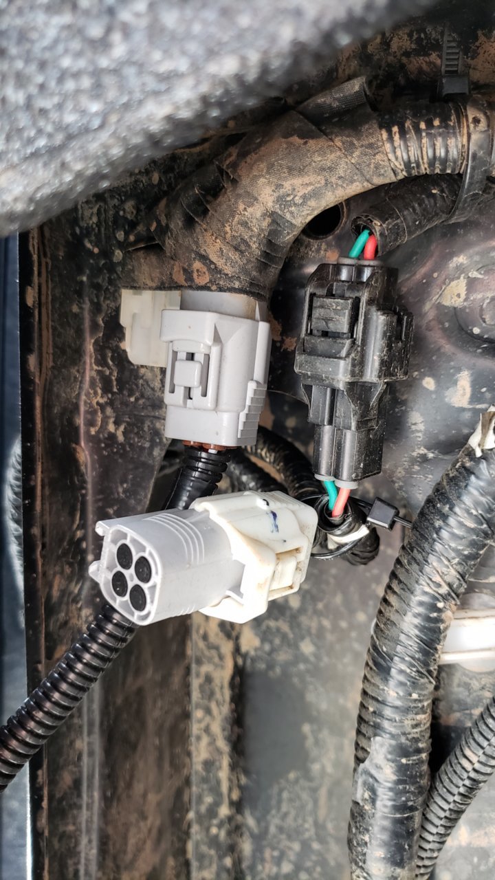

    So am I. The camera and tailgate lock both have plugs outside the tailgate. That's what I said. It's made so you can unplug both of them to remove the tailgate. They are/will be located underneath the truck near the rear.

    Passenger side. Facing rear. The unplugged plug is the OEM camera. I have an aftermarket camera that is relocated. That's what is plugged in there. Black plug is the Toyota tailgate lock. All on my 2017.

    There isn't one. Your truck should have come with one for the camera. There's two halves to that. Maybe the other half works? Or maybe you can source the blank plugs from the dealer or something.

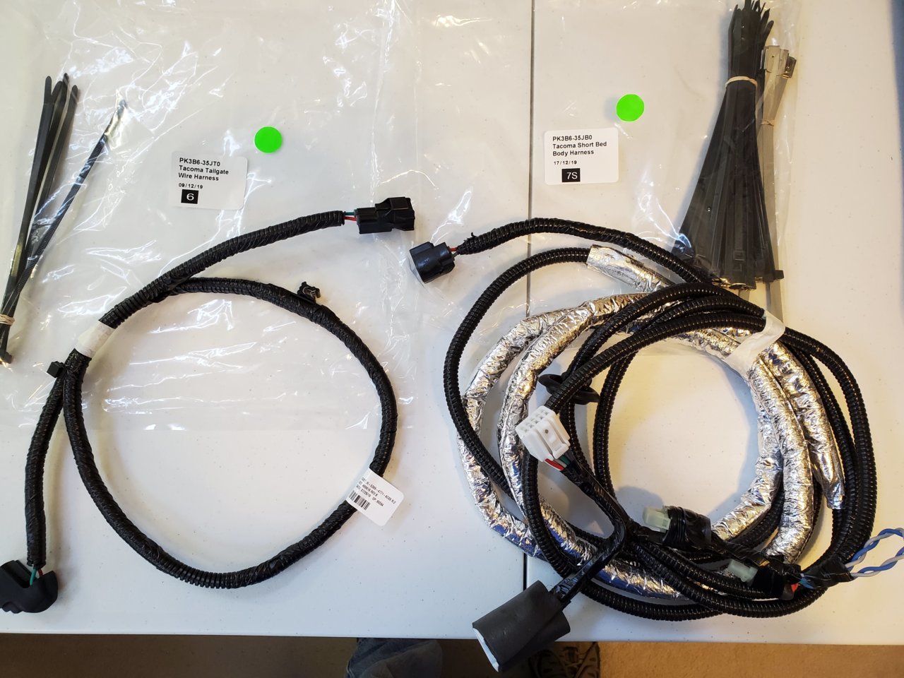

    Bilsteins 5100s on the top setting, 4runner Gray TRD Pro Sema wheels, 285/70/17 Toyo AT3s, Sumo Bump stops, TRD exhaust, ECGS Clamshell bushing, 1/4 shim for the lean and one inch rear block, OEM Pro grill and garnish OEM TRD Skid plate, TRD CAI, Demon Brackets, Rigid Industries Pro fog lights, OEM Trail Rails sidebars, Diode Dynamics LED SL1 high and low beam lights, OEM Roof racks, Clazzio leather heated seats, Remote Start, TRD Pro shift knob, tinted windows, Rockford Fosgate 4 channel amp for the headunit and sub and amp combo, OEM Puddle lights, OEM tailgate lock, OEM bed mat, LED interior lights, OEM blackout kit for letters, JLT catch can, upgraded 27F toyota True Start battery, Vleds led tail light kit with Pro tail lights, OEM Rave4 side mirrors with convex spotters,just to name a few mods.
    I did this yesterday evening on mine and my son's truck. The kit is awesome, everything went as planned. The only complaint is the metal wire ties but they worked. The kit is all plug and play and pretty easy. Took me and my son an hour or so on mine and his took 45 min. since we knew what we were doing. Toyota should be proud of this kit, very good thinking on the rubber stoppers secured to the wire loom and the wires from the actuator. Very well thought out.

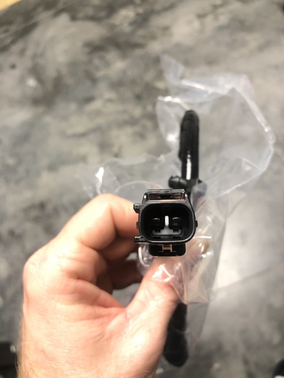

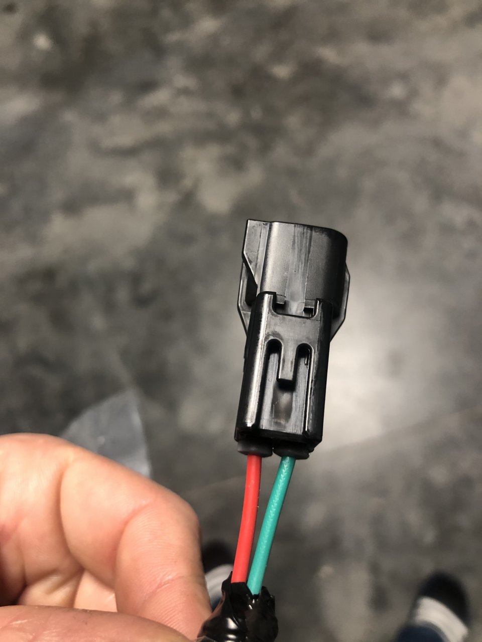

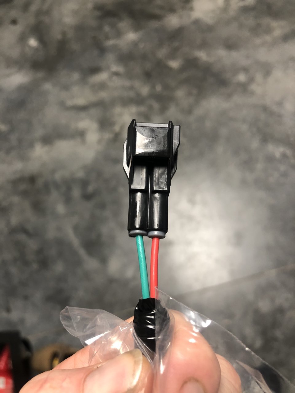

    Yes I have the plugs for the camera- we’re talking about for the tailgate though. (Which are different from each other- 4 plug/2 plug). For a complete kit like they provided with the plastic dual harness clips, heat shielded harness/metal ties, grommet etc they sure missed this one thing with the plugs on tailgate removal as they did with the camera. Will I ever remove the tailgate… probably not but I feel incomplete :rofl:
    sourcing would be the only option. I forgot to take a picture of the other end
    @caribe makaira
    E6C75A94-1CC4-43B8-8CA8-908F7A9C809F.jpg 178AFC82-9170-4D0D-B1DF-B0038D38A89C.jpg E505E71F-80E4-46A3-BF5F-9E84C4B660A5.jpg
