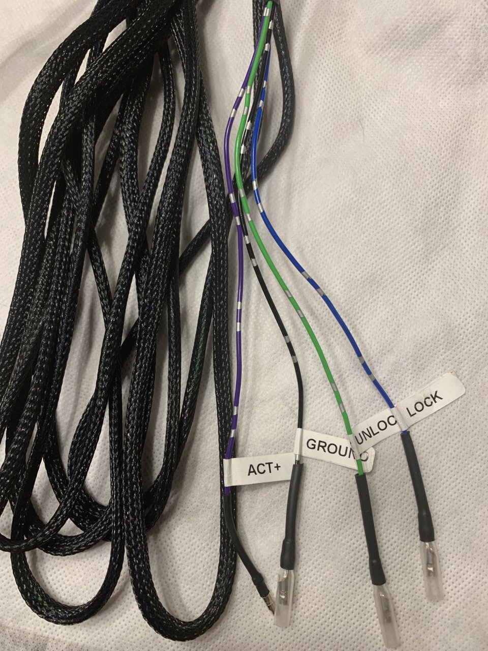

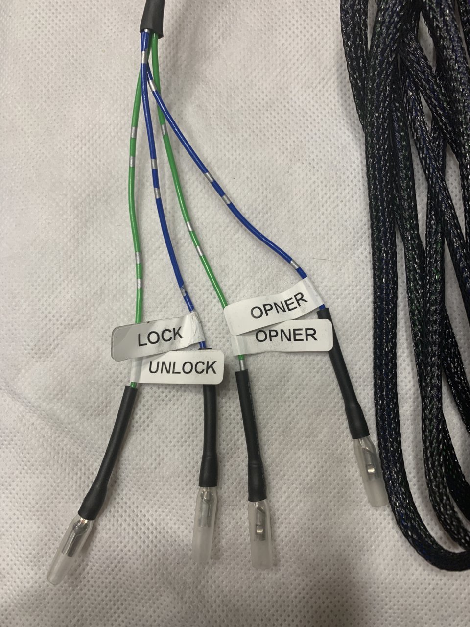

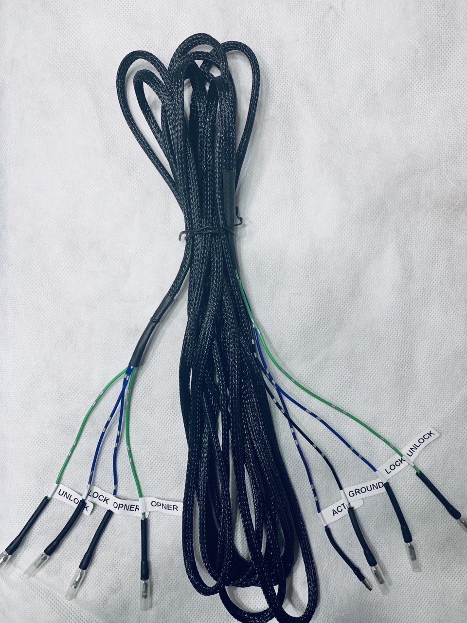

    @SouthtownTaco come on over. You can get that on my website at www.ktjo4x4.com. Also, for those interested in the Tailgate Opener, I just received a couple messages that have only seen this kit and not mine until after they have purchased this one. I don’t know if the OEM Kit has the connections or not, I just purchased a kit myself so when I get asked questions I can answer them (even tho it is expensive but it’ll give me an idea of what the OEM Kit looks like. I did find it for $130 tho. I’ve been told it looks a lot like mine o_O with just added gadgets to raise the price). However, if the OEM Kit has the following Connections, then it will be compatible with the Opener Kit and your will be able to just go on my Website and purchase the Add-On Kit. If the Actuator doesn’t have these Connections then it will not be, UNLESS, you would like to modify your OEM Kit.
    This will be the New Harness, but it shows you the connections you need on both ends as well as the PNP Harness needs to be able to have the Connections too. I wouldn’t want any of you to miss out on this amazing mod or the ones to follow like the Foot Sensor for the Power Tailgate Opener Package
    P.S. For those that may ever need another Double Wire Harness Protector in the Future, I will be having these made by my vendor and will have these available for purchase, as well as these will come in my kit eventually. Prior to the Chinese New Years I had this Quoted and we were ready to place the order and then everything went crazy. They will be a lot cheaper than what Toyota is charging people for them which I believe is like $40-$50 or something crazy like that. Just wanted to put that out there. I believe my vendors get back to work next week or the following and then I plan on shipping them a huge package of items when they say it’s clear.

    That tag typo "Opener"! :annoyed:
    KTJO 4x4[QUOTED] likes this.

    :rofl:The factory whipped it up quick for me prior to their vacation so no complaints from me as just a demo harness so I could see it and approve it, but agree. I think that was the first thing I noticed rather than it looks great and you made it just like I asked and wanted. Us Americans. It’s the small things in life right. :rofl:
