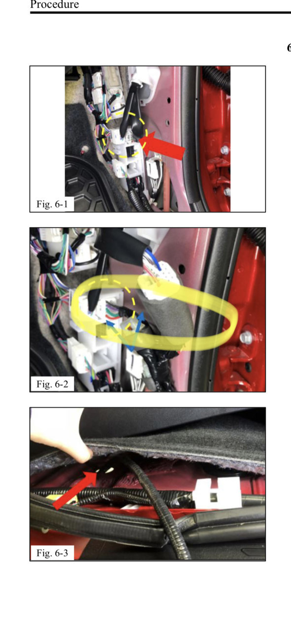

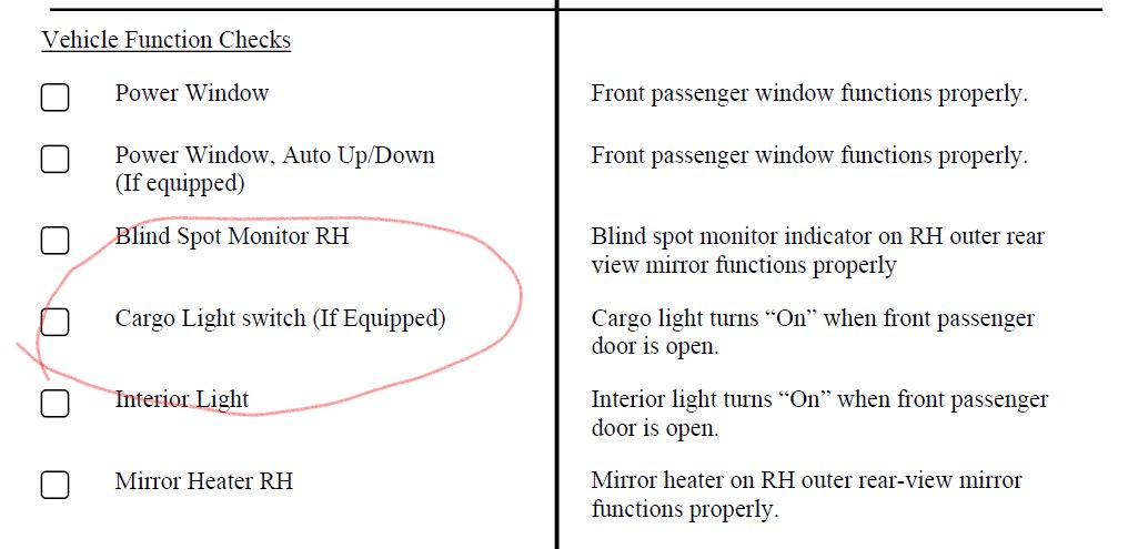

    The other possibility is that the bed lights are operated by the cargo light switch in the 2020+ and that wiring has changed. I noticed they have a function check for the cargo light switch.

    I have seen it mentioned in the part number thread that the bed lighting does in fact use the cargo light switch in the 2020s and this is supposedly pre-wired. The talk there was that you just need to order the lights and harnesses to plug in at the rear. I don't have the kit yet since it isn't available. I would love to hear from someone with a 2020 that has the bed lights installed that can confirm.

    At least for the '16-'18 I thought the bed light wiring ran to the drivers side, not passenger...that's at least the instructions route it when thinking of using the bed lights pn PT948-35160 but again these new 2020 lights seem more integrated and may be a game changer

    Love to see a pic of the Y harness up close and all sides. See if the wiring colors have changed.

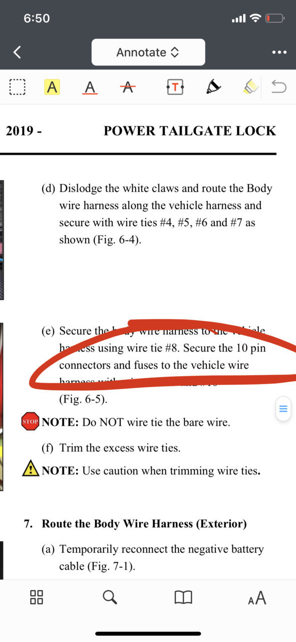

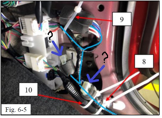

    Anyone know what they are? I'm thinking a diode or a fuse.

    I just read through the install instructions. I like how thorough they are and the extra care on the harness near the exhaust. But the pop n lock is plug n play with the pnp harness by Katie. BUT the included bezel for the bed and tailgate are a cherry on top. And it seems this is fused when I don’t think the other options are. I haven’t even installed my pop n lock with the pnp harness so I may buy this kit and sell the pop n lock setup I have.
    I think the only reason the cargo light is on the check because of the jumper harness so they say to check it to make sure the connections are fine- basically open the passenger door and make sure the lights come on

    It said fuse in the install
    But why 2
