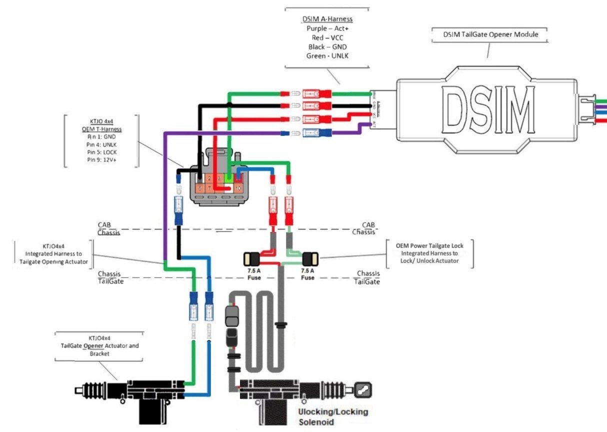

    Yes Sir. It is at the top of our diagram titled DSIM. That is the Tailgate Opener V2 Module.

    See I would of thought the oem tailgate harness needed to be connected before the passenger/driver twin unlock/lock harness.
    Reason being (in my head) is in the diagram you are breaking the passenger unlock/lock path for the twin action before the oem tailgate harness and I thought that path is required to get the tailgate lock/unlock to function since it’s supposed to tap into the passenger lock/unlock
    edit: shit, I thought the cab was to the left and door to the right. I missed that sorry

    It is... if you look at the drawing, the upper right is the “to cab” connector. The solenoid is the first thing.

    Yea I caught that after I posted… I was reading it like a book left (front) to right (back). I edited my post :anonymous:

    @NoOne i had enough time to get the tailgate harness installed last weekend but not the truck/cab side but I used the provided part numbers you posted to plug the connector :D:thumbsup:

    No worries, it looks like spaghetti soup to me too at times.
    I don’t know how many times I have seen something and it made sense, only to see it again and wonder what is going on. o_O It’s even worse if it is your own drawing... :eek:

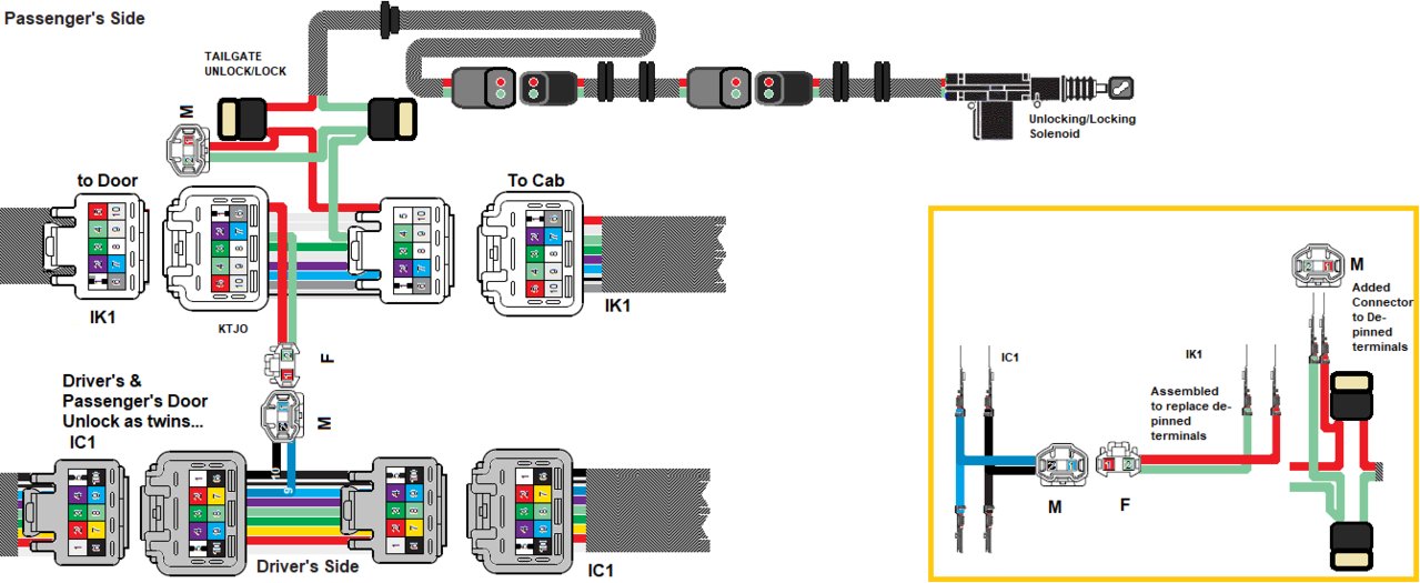

    You could also do this:
    De-pin the Unlock & Lock terminals from the IK1 going to door from the OEM Tailgate harness.
    Purchase these:
    You'll need 2 males and 1 female, and 2 pairs of terminals. One male will be inserted to the removed terminals of the OEM harness connector. (Door side)
    1 more pair of male terminals for the IC1 side, those would be cut and crimped, making the the IC1 a 2 slot dual wire. (9 & 10) The dual wire added needs to reach the passengers side.
    @KTJO 4x4 sells the IC1 with the required pigtails on slots 9 & 10...but you could do this yourself.
