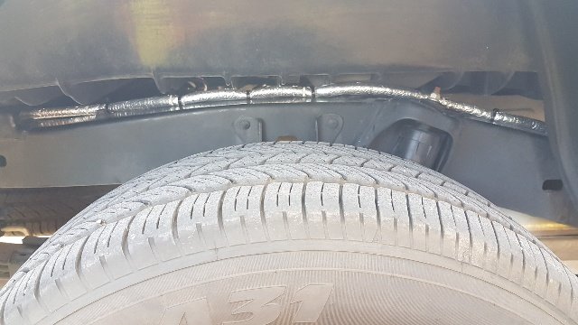

    I believe that the power tailgate locks are a dealer installed option that started in 2018.
    I finished my install but ran the wires over the chassis as there was not another harness running along that area. I am thinking to maybe run it on the inner channel now so it is not in view on the rear tire well. I noticed it sticks out like sore thumb and would be better protected. I felt along the frame rail chassis and there were holes on the top of the rail covered by rubber stick on discs and that's were I mounted and ran the wire loom.

    Installed mine exactly as yours since my harness runs on the driver side of the frame on my 2020.
