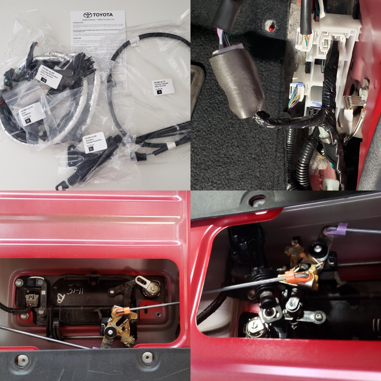

    IMG_20200624_181124.jpg Just installed in a 2017 SR5 DCSB, no issues. Simple Plug and play installation. As everyone previously states, feed harness from cab back and secure to frame. Works perfectly w key and fob, auto lock and unlock.

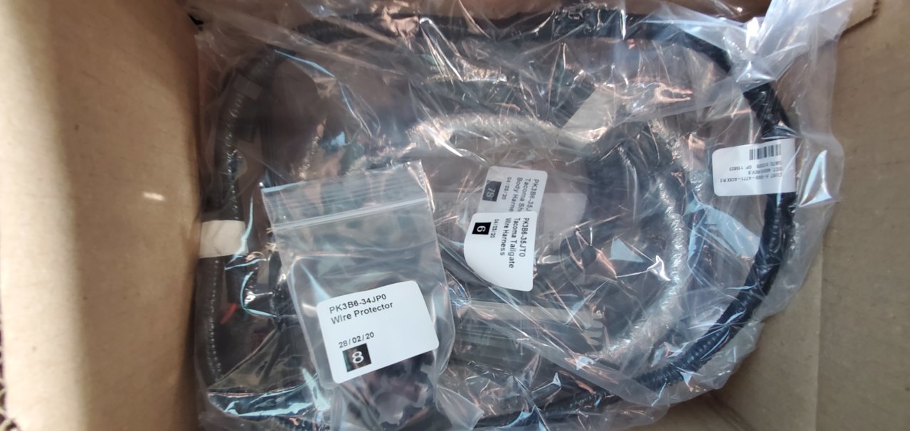

    Got my kit in today. Next day off, going to take the plunge and install. 20200627_171906.jpg
