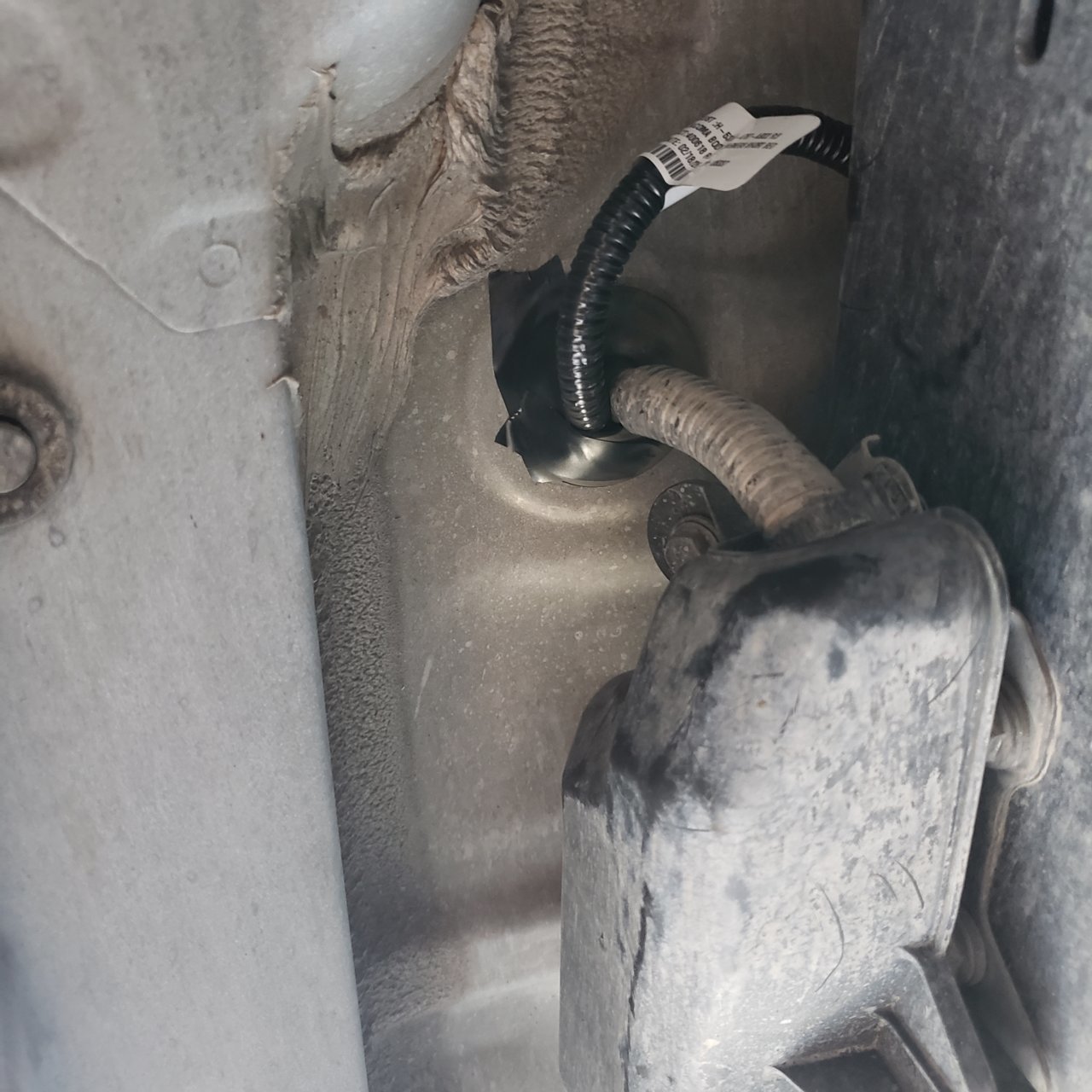

    Installed on my 2016 4x4 sport. It says to go through the passenger grommet but mines had wire coming out of it so i slit the grommet in half and ran it through the existing one. The instuctions led me to believe that there was nothing going through that grommet. But alas everything works like a charm if anyone was wondering about fitment. Heres a pic from under the truck of the grommet

    There should be an unused grommet on the other side of that plastic cover.
    eclane likes this.

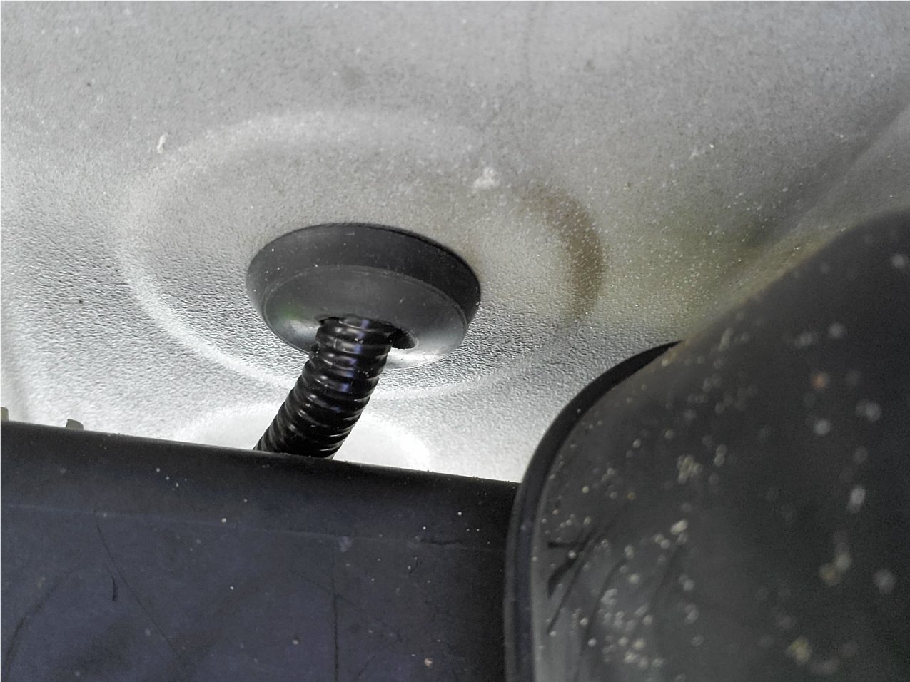

    This is the proper location as specified in the installation instructions. Several people have had trouble finding it (including me). I pushed in the grommet near the center of the passenger side rear floor before realizing I was in the wrong place. I figured out my error before running the cable through there. But getting that floorpan grommet back in place was not an easy task.
    This is where the cable and grommet should go. The existing grommet that's factory installed in that location is mostly obscured from view by the frame. It's located at the rear end of that plastic cover that is easy to find, but the grommet is tucked in between the frame and the truck floor.
    This post has another picture to help locate the proper grommet location.

    You expect electrical tape to stay put and keep water out?

    Lol that was all i had at the time. You got suggestions? There is little to no gap where i cut so i dunno ‍♂️

    At the least, I'd try to find some kind of waterproof sealant that I could mold around it. Rusty floorboards would be a mofo :eek:

    Id use black RTV. You may be able to apply it from the inside until it squeezes through the cut, then smooth it out a little.

    Thanks for the input homies. Gonna do that
