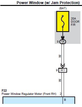

    This is why you should:
    And, Yes, you'll have to manually reset the features on windows and sliding roof.

    Not blow a fuse...mess with the module that handles the window anti-jam...

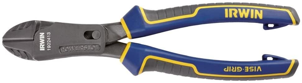

    In case anyone needs an excuse to buy a new tool, I found that these cut through the metal zip ties at any angle like hot butter. 6A6EB168-9C20-4E43-84E5-B95F7AAF41FC.jpg
